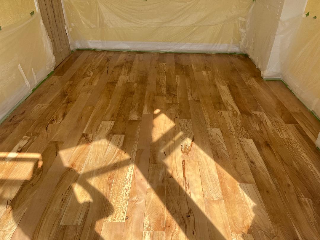

Finished final varnish coat using Bona Mega silk matt. I want to give floor final polish to remove bits of dust so I have a very smooth finish. Any advice on what to use.

I have some bits of dust in the final varnish coat - trying to figure out what to use to remove them - or do I sand down and reapply final coat?

It depends on just how much debris has been trapped, over an large area or a patch - if you can live with it (covered by furniture, say?) then leave it alone.
Or you could remove the dust by sanding down with a belt and an orbital sander but blending-in the varnish might end up with it looking worse than with the dust?
A few grains of trapped dust on a few boards - might try a very fine grit ( p600, p800) on a small area and see what happens.
