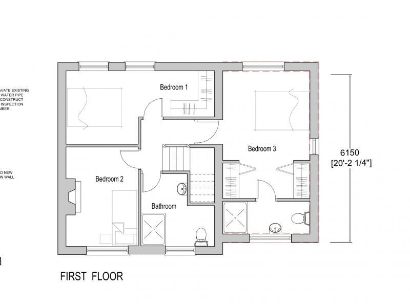

Hi all,
I was hoping some of you would be able to have a look at these two plans, the first is my newly agreed plan of the first floor, which I'm very happy with, it has a full height 3.5m x 6.6m extension to the side which I'm due to start fairly soon.

So bloody annoyed at his attitude I decided to look into drawing them myself (see second photo), I've measured and checked possibly 50 times but that means nothing if I've made a glaring mistake with the plans, so could any of you kind folk glance over these to see if they are good enough for a SE to make calculations from and do you think its a good enough layout, and do the stairs work?
Thank you
Assuming this is a loft conversion without a dormer, the SE will need to know which are the load-bearing walls at first floor level - so mark those on the plan.
Also direction of ceiling joists - presumably top-to-bottom of the plan?
Also material of construction of inner skin - ie lightweight block or traditional brick? This has a bearing on the padstones required for the steel beams
Send them some pics of the exterior of the house, and some taken in the roof space so that they can see where the main purlins are.
Thought I'd better add that the front bathroom will be smaller to allow for the positioning of the new staircase.. It's not ideal but it will be a shower room to service two bedrooms only. So I believe it will be big enough (1.5x2.5m)

Hi tony, yes it's without a dorma, that's a great idea about the load bearing walls below, I'll put that into the drawing.
Other then that are there any glaring mistakes?
Given that a shower tray is 900 square, I dare say your shower room could be more like an ensuite if done right
