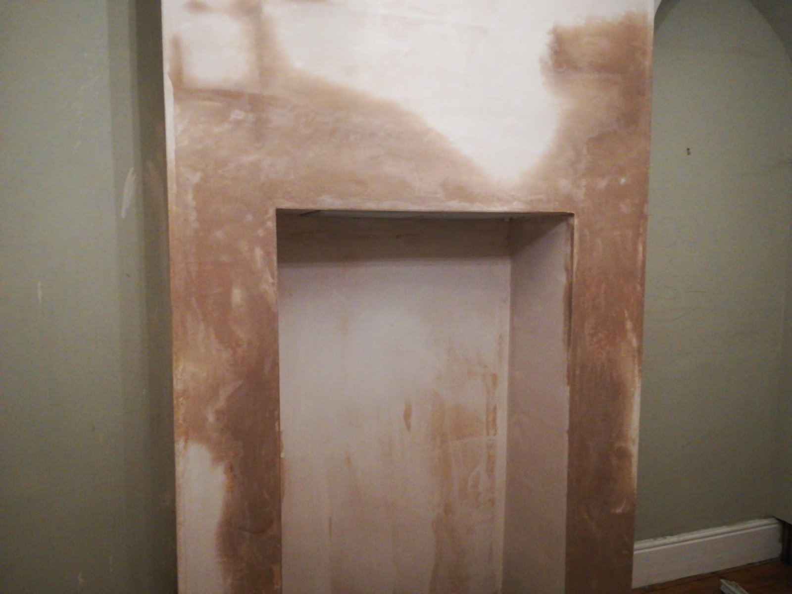

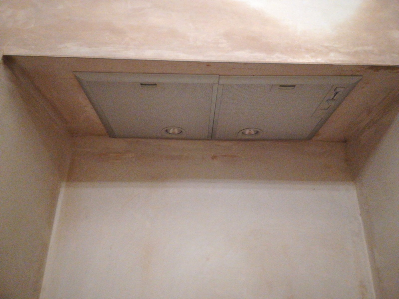

why dont you post pics of inside and outside showing any work so far and the air bricks?

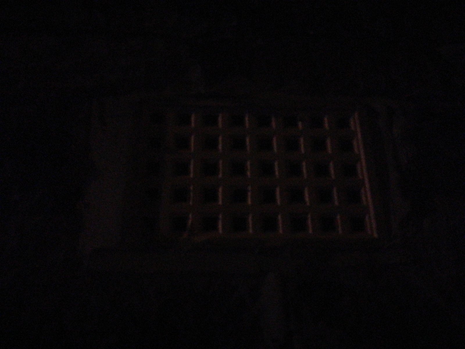

Good idea Bobasd! The external air brick is just about visible in the dark. It's a standard clay double air brick. The ducting is 220x90mm flat ducting. Thanks. It would be pretty straightforward to add an extra vent into the plasterboard between the extractor and the new lintel, which is 40cm above, but obviously would affect aesthetics.

thanks for the pics.
i can't see any detail in the brick photo - what i was looking for was a context showing the height and position of the air brick that is venting the bottom of the flue?
i cant see where the flat ducting leaves the chimney breast either or where it goes, and how its terminated?
The ducting comes out of the extractor and elbows 90 degrees out through the back of the chimney breast and external wall through the air brick. It isn't connected to the air brick with an adaptor, it is just shoved right up against it. The height of the airbrick is about 400mm above the extractor.

Good idea Bobasd! The external air brick is just about visible in the dark. It's a standard clay double air brick. .
that is no good for a powered vent to try and blow through. The holes you see diminish in size when they get to the inside. The airbrick wants taking out and replaced with modern plastic ones -2 will fill the hole. Then the vent duct will have a good chance of blowing out.
