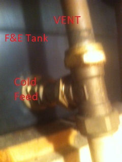

Is the combined F&E like mine below, the very best type IMO, some rads are > 40 years old.
It was.
I removed the vent overflow pipe recently because investigation suggested it was a good idea (Std practice for BG) and it was the exact setup recommended in the boiler iom.
Made a huge difference. No more pull down in pump start up but the air ingress still remains.
