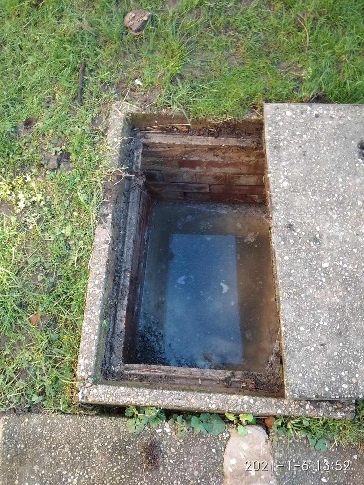

Looks like the blockage is downstream?

Hard to say from just one manhole, could be blocked further down, or just at yours. If you’re able to check further down, I’d recommend it. Also if shared (not 100% with you being in Scotland) then the water undertaker can unblock it for free.
Get it jetted!
Andy
Yes, if anyone does it, it won't be me!
I think it's shared as it is downstream from me, so I will get in touch with the water company.
The only concern I have is that I am the first house in the block of terraced house, so my connection to the next manhole is not shared with anyone.
