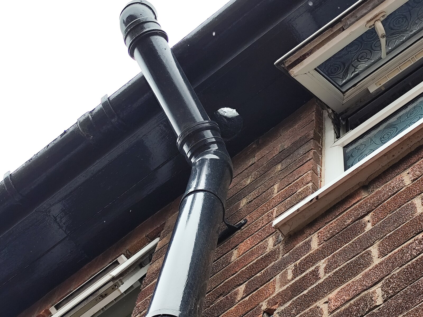

Hi all, I've had a long term heating and hot water issue as my wiring centre is in the loft and the wiring does become oxidised and the hot water and heating intermittently come on. @Johntheo5
It has finally been diagnosed there's too much moisture in the loft. I have two extractor fans going into the loft void and they're not vented!
Could I vent through the fans through some eave vents? And have a roof vent tile to bring in fresh air into the loft?
Any ideas and suggestions would be appreciated.

Not surprised the wiring is oxidising.
The extractors have to be vented outside either tile or soffit vents.

The old soil pipe used to go through the soffit does this mean I could vent through here?

will an opening already be present from the loft as the soffit has a hole?
There may be limited access, yes. There is some (but not much) gap between the underside of the battens and the wall plate, depending on roof steepness and whether you have plains or pans.
