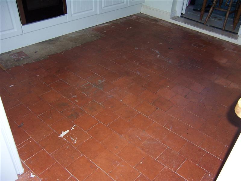

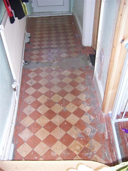

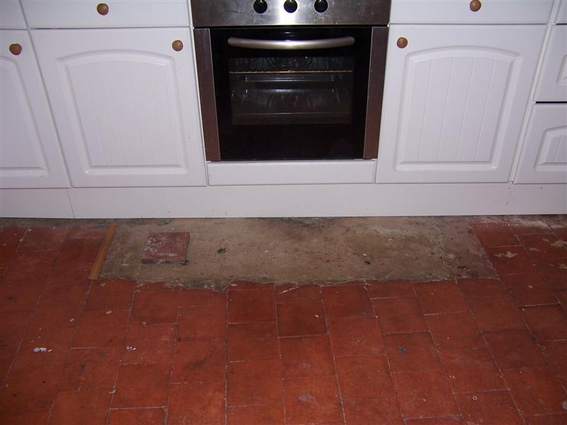

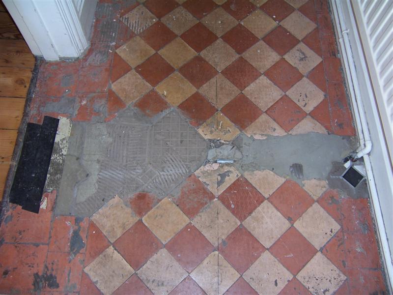

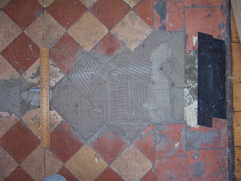

I live in a fairly run-of-the-mill Victorian terrace and recently uncovered an original (patterned) tiled floor in my hall, and a terracotta tile floor in my kitchen. Both have some damage - in the hall where a section was dug up to install a central heating pipe (damage about 40cm x 100 cm, a 2 tile depth) and in the kitchen an area of concrete underneath a chimney breast (about 40cm x 145).
I have tried - with difficulty - to find a way to restore these tiles. I have received 2 quotes - the first came in at 4000 pounds (which is way beyond my means and would no way provide a return in value!) and the second for 850, but the chap couldn't do it before next March.
Is it worth trying to track down the right tiles and find someone locally to lay them? Or do I need a professional restorer to do the job? If so, can anyone give me an idea of what would be a reasonable price (given that the 2 quotes were miles apart)?

Sarah - I think restoration should, if possible, always be the preferred option in old houses.
Clearly, your problem is sourcing matching tiles. Go to www.salvoweb.com to discover your local salvage yards (or check Yellow Pages), you might be lucky. Warning ... hunting for salvage matches can take months but ultimately can be worth it. Clean a couple of tiles (use White Spirit) then take a decent, close-up photos and use these snaps to email to salvage yards further away. Contact your local Victorian Society - these guys may know local sources.
I've used Drummonds, in Surrey, to source stuff in the past ... they've been really good - www.drummonds-arch.co.uk
