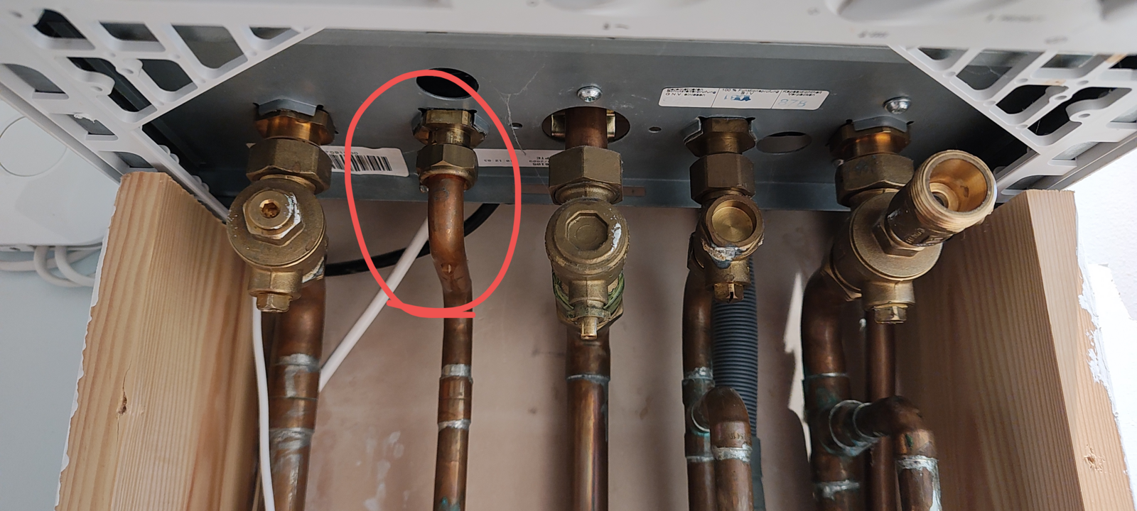

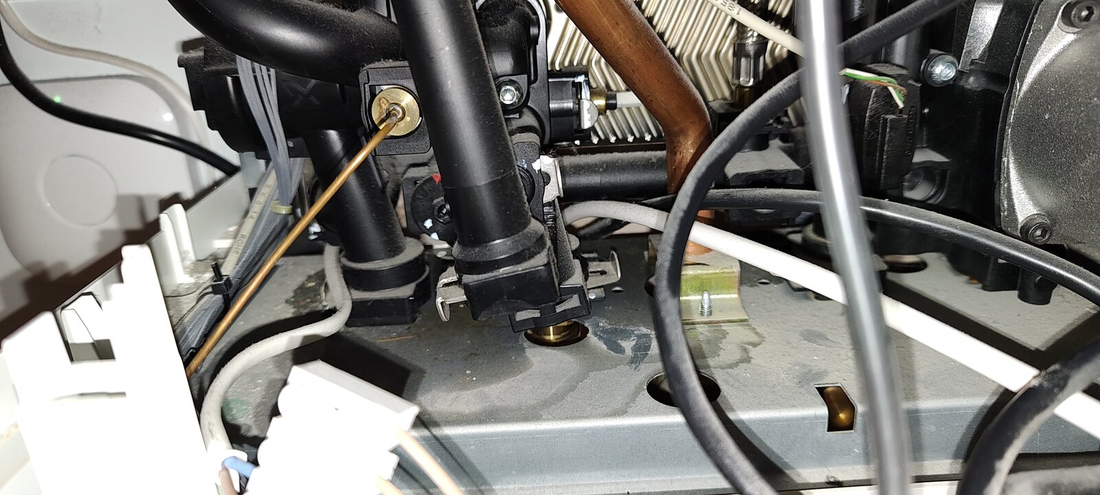

I'd also read that if you repressurise the system and then isolate the boiler flow & return and monitor for any pressure loss this would indicate whether the boiler may have a fault or if potentially there may be a leak with the central heating pipework. So last night I did this and this morning woke up to a puddle on the floor underneath the boiler with some pressure loss (perhaps 0.2 bar) - I checked the upstairs radiators and they were all still full of water. I wanted to make sure that the boiler hadn't been flooded out, so did remove the case just to visually check and luckily there wasn't a massive amount of water around, it does appear to be coming from around where the heat exchanger is though and exiting where the hot water supply pipe is (but not from the actual pipe itself).
Now I did also just check around the schrader valve on the vessel and quickly pressed it with a screwdriver, air did come out, but some black water too, so I don't think that is a good sign? Just really not sure what happens if an expansion vessel fails where the water goes if this is not coming out of the pipe outside?
