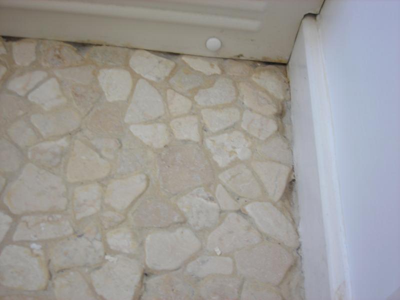

I need to deal with a very bizarre crazy-paved style bathroom floor which is very uneven and has huge craters. It's horrible. I think it would be a hell of job to remove it, and the plan is to lay some vinyl tiles over it. I realise this nightmare floor would have to be levelled first but I have no idea how to do this. I've looked into some sort of screed/self-levelling compound but am I right in thinking this is only suitable for only slightly uneven floors? Is laying ply the best way forward? Any help would be greatly appreciated.

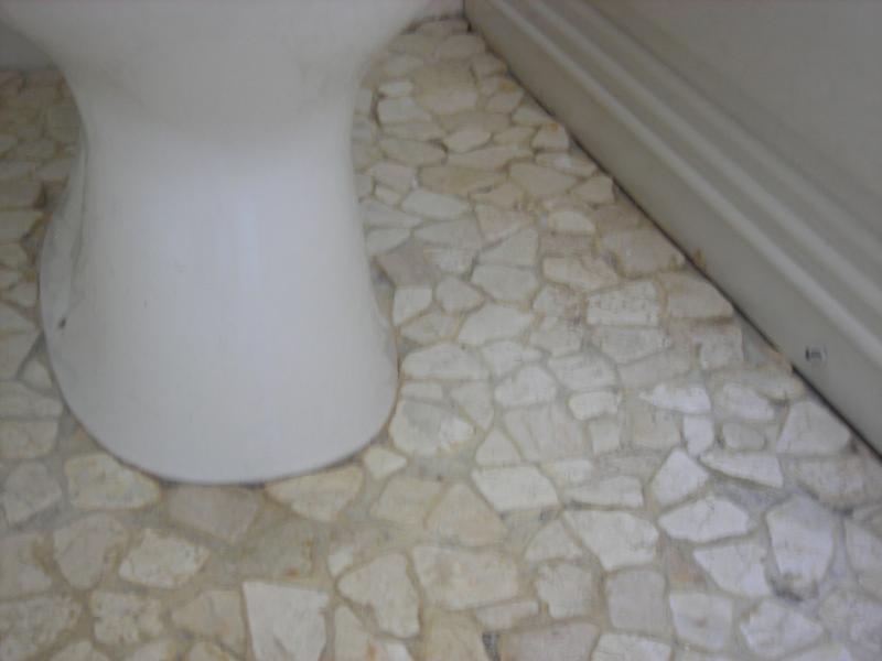

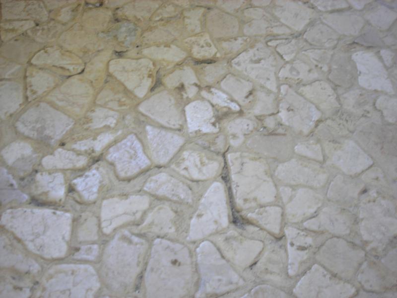

Thank you for replies/suggestions so far. Please see pictures I have attached. They are not brilliant but hopefully give an idea. There are cavities of probably up to about 15mm in some places.
Nice............... :shock:
.....Ok - that will screed no problem
it may need a second layer but I doubt it, I have seen worse!!!
You should really consider talking to a competant fitter now, self leveling is no good and good screeding is a mysterious art - when you CAN it looks easy, when you CANT its going to get messy.
......looks like someone fell in love with the local beach and decided to bring it home :?
Edit - by the way you may need to modify your bath panel to allow continued access - make sure you question your fitter about how he intends to achieve this!!!
Ok, thanks very much for your advice. Was thinking of attempting this ourselves but wouldn't want to get into an even bigger mess than what we've got now, so maybe not...
