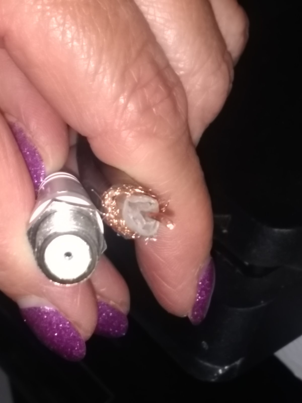

Had a VM engineer here to replace TV box that gone tits up. He couldn't connect old cable(screw thread) to new box adaptor(copper wire too big).
Anyone know of a connector that would fit both ends. To put another cable in, it will have to run along skirting boards (which I hate). Cheers for any replies.
The fattest of the 'normal range' of domestic coax cables has a diameter in the range of 8mm to 8.2mm. There are screw-on F plugs made for this thickness of cable. Here's just one example: LINK
For completeness' sake, your average TV coax is a 6.7 - 7.0mm diameter. There are also two smaller diameter cables at roughly 6mm and 5mm that are also used in domestic installs. Each has an F plug design for the specific size.
No matter what the collar size, the nut part of an F plug is always the same size, so any of the above plugs would screw on to the threaded end shown in your picture.

Cheers lucid for reply. What I did to connect the box was use a push on coax fitting. I didn't use there little bit of cable supplied. Channels are still not 100% thou, so going to have to contact VM again.
