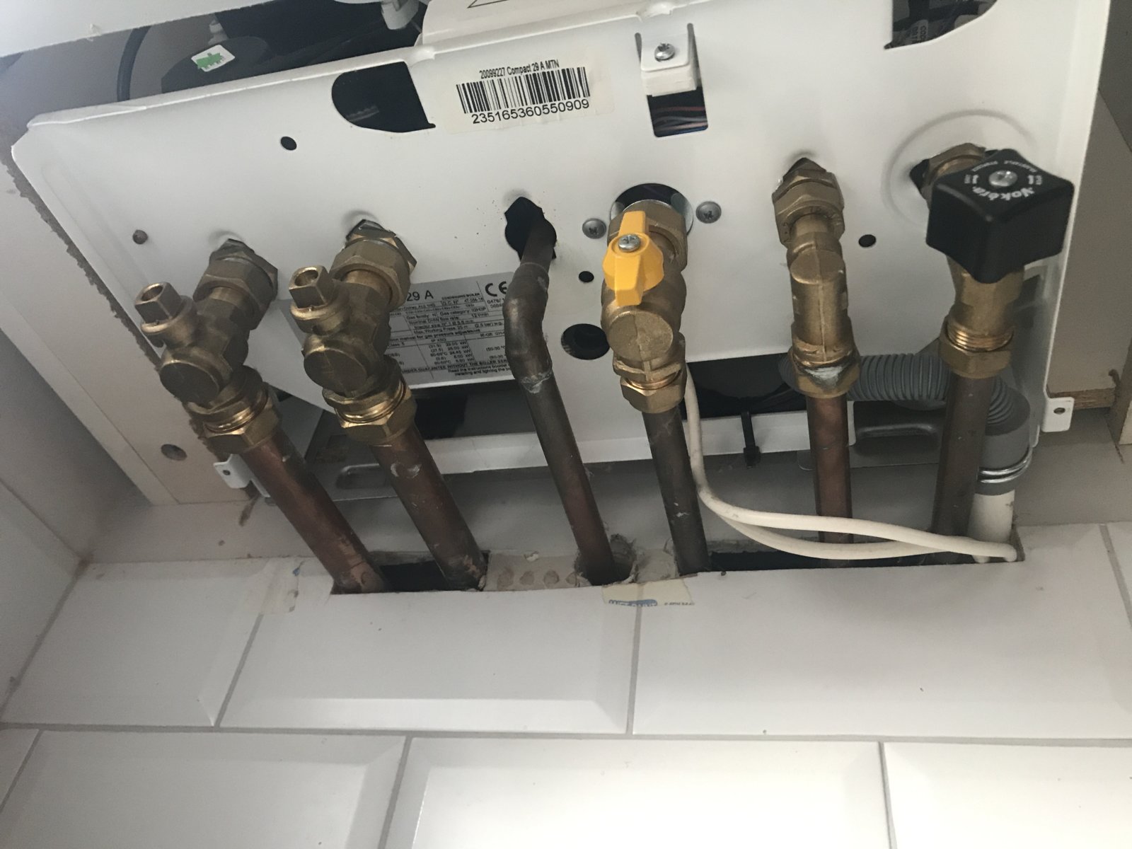

Hi, my boiler currently has very low pressure. I have looked online for the boiler manual and still none the wiser on where on Earth the filling loop is, can anybody be of help?
Please see attached photo
The filling loop is not shown in your pic ,look elsewhere. The pipes below the boiler go into the wall ,track them from the other side ,follow where they go.
your boiler doesnt have an inbuilt filling loop, follow the cold water inlet pipe, furthest right with the valve with the black knob, and you will come across the filling loop, it will be a hose between two pipes, it might be disconnected and you might have to connect it
