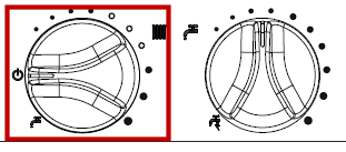

Hi all,
There is currently no hot water or heating in the house and the boiler is showing a flashing red and green light, pressure is almost 1.5 bar.
I looked online for potential fixes, tried turning it on and off at the mains, tried putting the switch to OFF then letting the hot water run for bit and put the switch back to ON in the hopes it would kickstart it again but no luck. Called the company desk and they suggested a £300 call for an engineer which I can't afford.
Does anyone have any other suggestions of things I could try to get it going?
Many thanks
Was the pressure low and did you do a reset? Try a reset, turn it to the power symbol for a few secs then back on to the heating mode and if it still persists it might need looked at, that error is indicative of a sensor fault.
Hi mate,
Thanks for replying! The pressure was not low, between 1 and 1.5. I have also did a reset a few times as you've described but to no avail, ran out of things to try so currently trying to find some quotes for a callout charge as not had to use one before so don't know what to expect.
