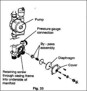

Is the pump flow switch diaphragm stuck in the "run" position, this may cause the burner to operate even when the pump is not running, that would explain the kettling as well! ;)
The pin can stick in the outward position, due to carp build up blocking the holes in the casting a failed diaphragm can also have the same result! ;)
Are you sure of that?
Many ( all ? ) Vokera designs buck the trend and rest out and move inwards when there is a flow sensed!
Where is DP when he is wanted?
glazier is right, it moves in when the pump operates. No matter as it won't leave the boiler on as it needs a demand to do this IIRC. even if it sticks in the NC position, and it usually does, it just means the boiler will fire up quicker and if the pump is gubbed the limit stat will cut the boiler off instead.
Thanks guys. I've made some major progress. I got a new diaphragm and took the flow switch off and replaced. The old one was not too badly worn. After a lot of fiddling and working it through, I got to the bottom of the problem. As Agile said, the flow switch is backwards, it pulls in when there is a flow. And this is achieved with an air inlet (might be water, i'm not 100% sure) from the flow pipe behind the manifold. Not sure if that makes any sense to you guys, but the issue was the little hole was blocked and so the flow switch was stuck.
