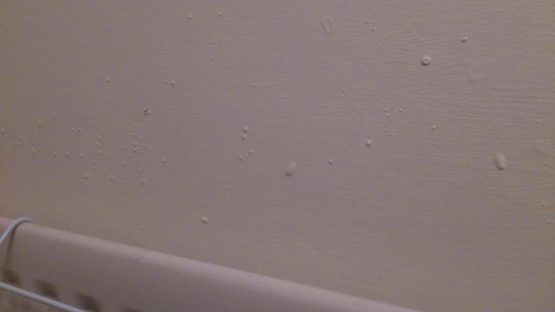

Wall paint bubbling up - how to remove
Would it be worth trying a steamer to soften the paint then scrape it off?
I'm tempted to give this a try as it seems easier than sanding. See if I can get a cheap steam cleaner then use a wallpaper scraper? Or a hamilton scraper?
I would just use a standard scraper - not a blade scraper (if that's what you mean by a hamilton). You'll probably find out quite quickly if it's going to work. If it does, I would suggest washing the wall as you go - whilst the surface is still 'soft'.
I got round to this job at the weekend and despite all the questions, it actually came off mostly by hand! With the wall warrmed up (by radiator and portable heater) I stuck a finger behind one of the bubbles and was able to slowly and carefully 'peel' it off in sheets, as if it was vinyl. Very very strange, it had clearly never adhered in the first place. It needed a bit of scraping at the edges but it's mostly stripped now.

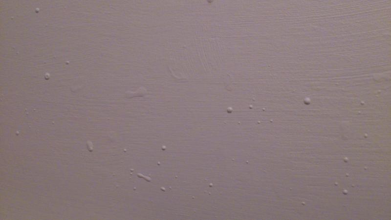

The paint underneath is indeed matt and was a little powdery. I started to clean it with just a damp cloth at first, and was surprised to find that it came off the wall very easily (see 2nd pic) with little rubbing. I havent done anything else after that pic.
So my next question is what to do with this wall now! Shall I simply wash it down with sugar soap and water, which will strip off the grey coloured paint and leave me with the cream colour underneath? Or am I best off sanding it? Again, I'm sure it wont take much sanding to get it down to the cream coloured paint underneath.
