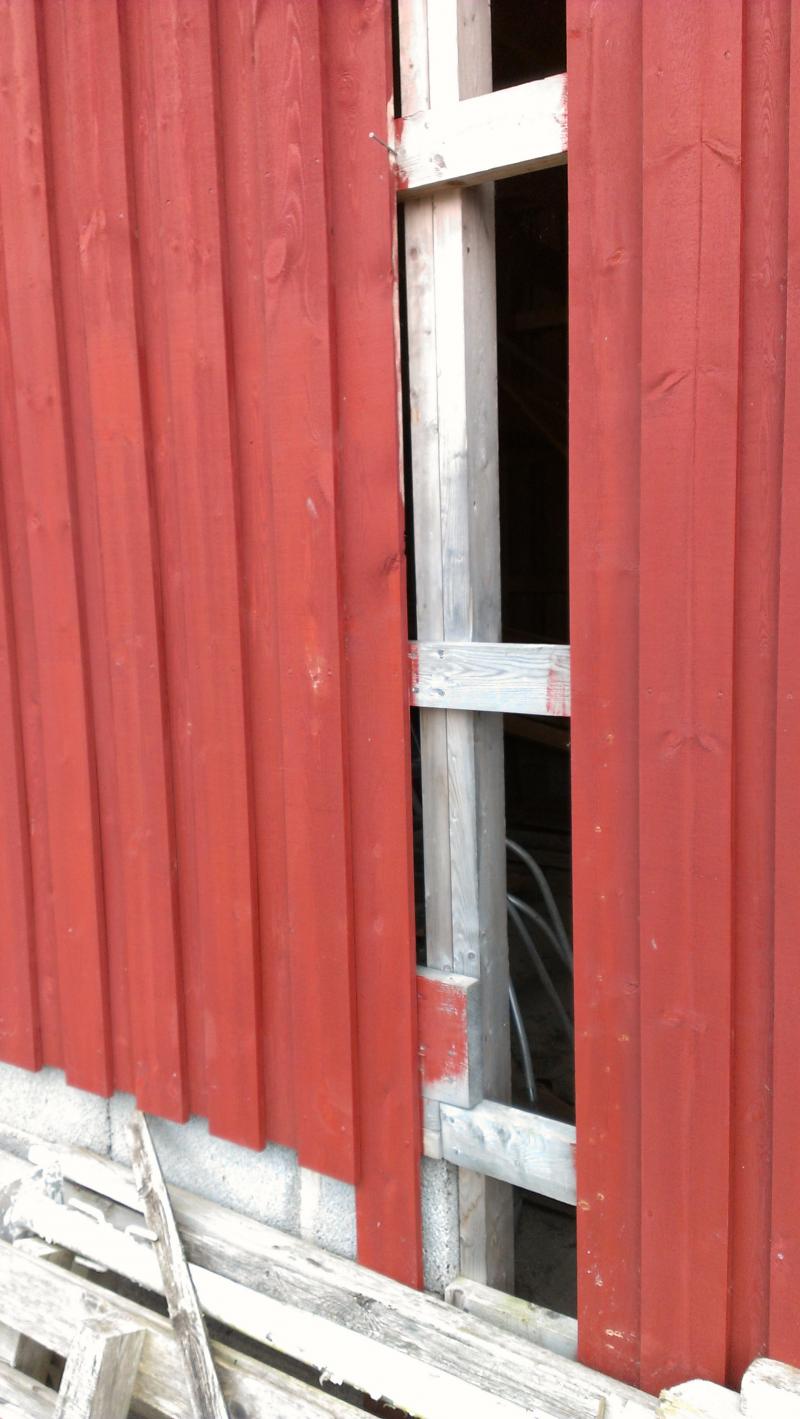

Hi... Got a question... Just built a small garden shed with vertical cladding on the outside horizontal Batens, breathable membrane... Ply...6x2 wall with full insilation then vapour barrier... Is this the correct way of doing it? With the ceiling I had 8x2 joist on a slight fall to the back.... With full insilation... And vapour barrier. I'm worried now tho that I will have condensation happening in the joist space because my roof is Not vented with it being a rubber felted roof with full insulation.... Should I be worried?
With the roof, as long as the vapour control layer is on the warm side of the insulation and pretty-well imperforate, you should be OK.
But if it's a small garden shed, why the concern? Surely there won't be too much water vapour in there, and sheds usually end up being well-ventilated anyway.
Thanks for the reply... When I say a shed is a glorified shed.... Plasterboarded and plastered.... The only reason I was concerned was because I have 6 holes in the ceiling for spot lights witch in my mind has now punctured the vapour barrier and it seems to be sweating between the insilation and the vapour barrier, any suggestions as to why that would be? Cold air coming in from the holes of the spot lights and condensation with the warmth of the roof perhaps?
