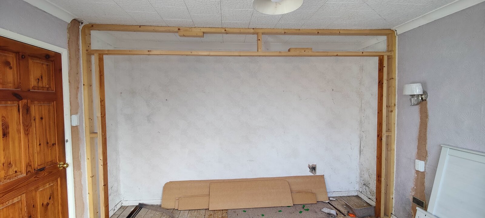

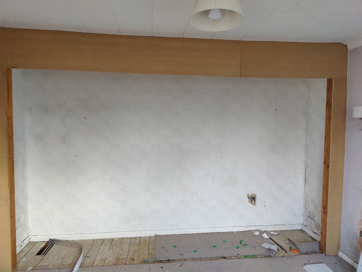

I am refurbishing the bedroom and I plan to fit new sliding doors, probably the Spacepro system. You can see my opening in the pictures.
My question is which should be ideal, to order custom height doors going up to the ceiling, or to keep a lower opening in order to accommodate the standard 2260mm?
I have some Spacepro doors in a situation very much like yours.
I went for the lower opening, as my ceiling is quite bowed - not hugely noticeable until you put something straight against it!
If you want to go full height, check your ceiling is plumb and level first :)
I would use standard height. If possible/sensible, make the width up with at least three sliding panels - it makes access into the wardrobe much easier. My version uses 6x panels.
