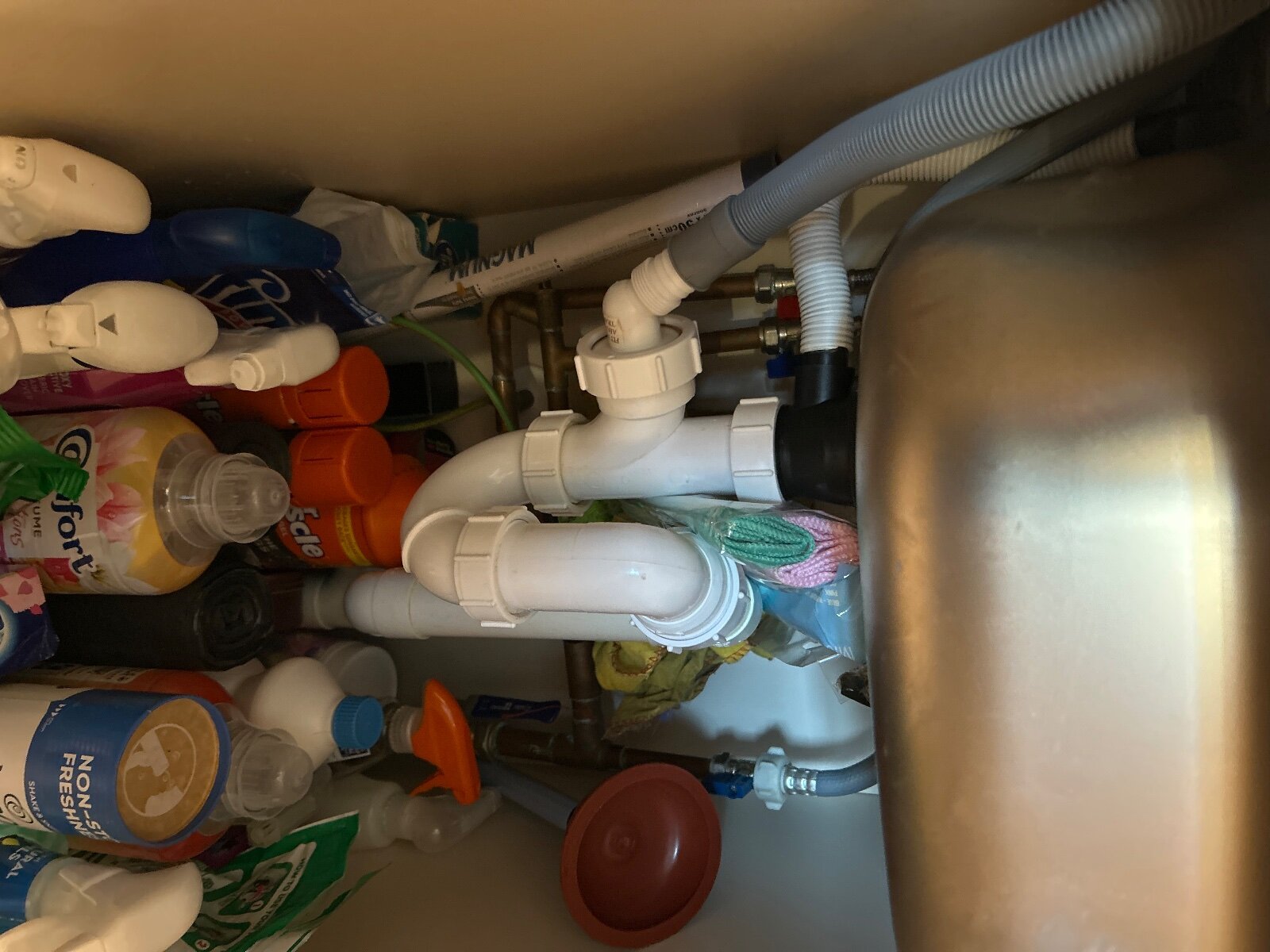

I just had to get rid of our old washing machine as it do not drain properly and smelt. Just used the new one for the first time and it has not drained properly. What could be the issue?

Looks fine, check the drain hose/connection is clear and the machine is pumping ok.
Take the u bend off and check that's clear, is the sink draining OK? Can't see how a drain smell could be associated with a washing machine in that set-up.

To test your new machine. put the machine drain pipe in a bucket to catch the water if you think there is a problem.
Take drain u bend apart and clean out as probably clogged up I'll guess or tape up sink overflow hole and plung sink for all your worth
