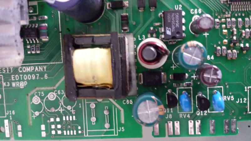

    C17 cap is faulty on the pcb. Look at the sticky at the top there's a link how to change it. Cost 50p from maplins and a soldering iron.

    I had a busy Sunday,finally had time to get that main board out.There was nothing wrong with the capacitor! Even so i replaced it with 1000mF 10V.Put everything back on and NO Change at all ! It might be something else wrong!

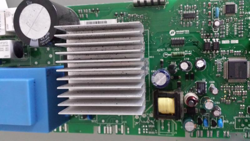

    Would have been a good idea to have taken a photo of both sides of the board and post them on here.
    Just because a cap is not leaking or bulging does not mean its ok, these are just visual symptoms of a very bad cap.
    What is the condition of the front fascia control board like? These are known to get wet and corrode tracks/connections, perhaps check both sides of the board and connectors are firmly seated.
    • Thanks Thanks x 1

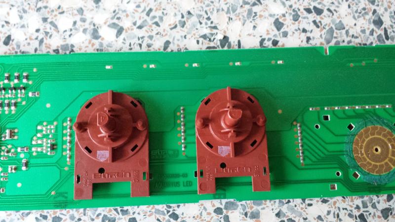

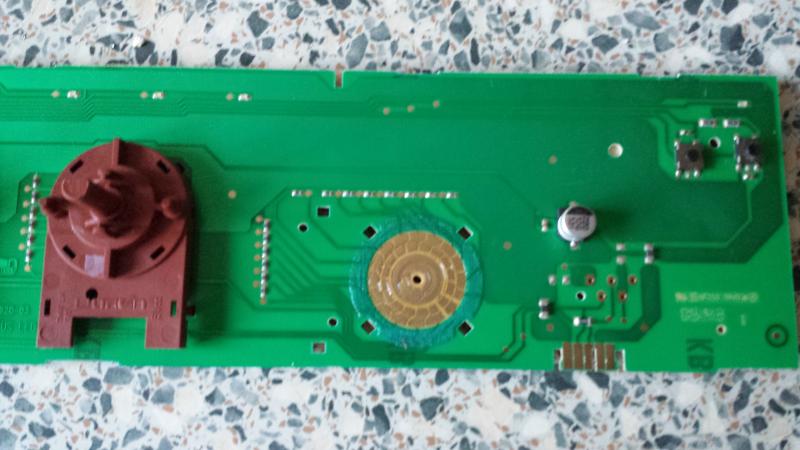

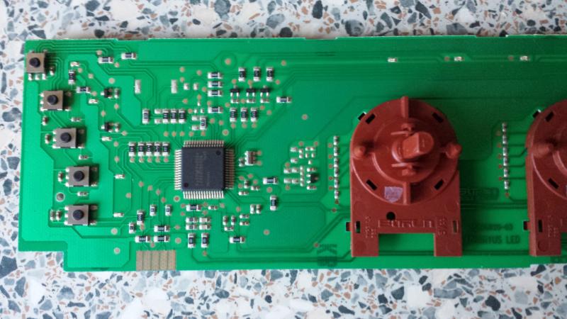

    Here there are some pictures:

    Those photos aren't very high quality and really need to see the whole board, both sides.
    However the board looks good from what can be seen, nothing obvious sticking out.

    I open and checked frond fascia board,did not find any damages rust or loose connections,also inspected a door lock - nothing wrong there.
    I will upload pictures later. Still not rectified the issue.
