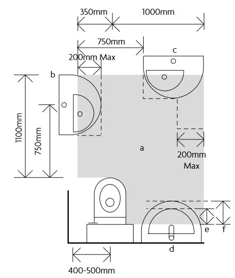

The problem is to decide where a partition has created another room, Part M I think defines what size showers, wet rooms and bathrooms need to be.
There are a series of diagrams like this 1692397236185.png that show the minimum size, I am sure this house would not comply, I know my mothers house we did not have quite enough clearance but the LABC inspector allowed it. The only thing he did insist on was the extractor fan, which reading the approved document was not required, but he insisted one was fitted.
