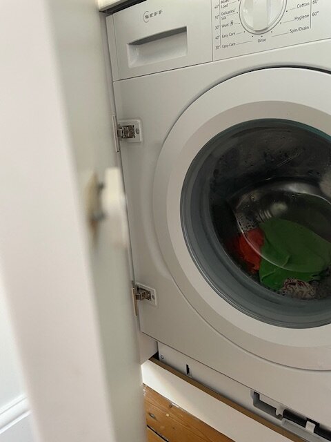

Magnet failure - can anyone advise please The magnet on the panel door (integrated washing machine) has stopped connecting to the magnet on the washing machine (NEFF under two years old) I bought and replaced the magnets - tested both magnets for their magnetism all of which are magnetic and yet the door still refuses to engage the magnets to close magnetically. It is a mystery. Can anyone advise pleae and thanks

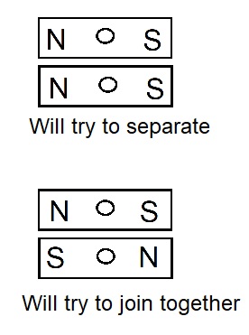

Thank you so much -for such quick and useful advice. I tried the 2p pieces - I can get one to stick to the magnet on the washing machine side but not the door magnets (presumably a polarity issue) - loosening the door magnets doesn't solve the issue either so I'm thinking the door alignment is the issue but I'm not confident in adjusting this
Or perhaps they are not magnets, just simply steel, intended to connect to the magnet?

That reads as though something is preventing the door closing completely, so check the door hinges or for anything that could be preventing full closure.
There is no magnet on the door it’s simply ferrous metal. If it’s not working it’s misaligned. Put a short screw ( point out) on the magnet and close the door it will mark where the plate should be.

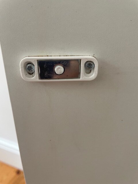

2nd picture with magnet fully loosened will catch washing machine but clearly not a satisfactory solution at all.

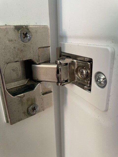

1st picture is hinge - all 4 screws are tightened to the max it seems
Ah, now a photo has been aired, I'd hazard a guess that the machine has moved slightly from its mountings in the cabinet carcase and original position, or, the hinges need a good overhaul/checking for wear and replaced after lubricating. Nothing in this life lasts forever including cabinet hinges which will require adjustments as they wear over time.

A photo of the WM catch would be helpful . You could always replace the current magnet with a magnetic touch latch .
