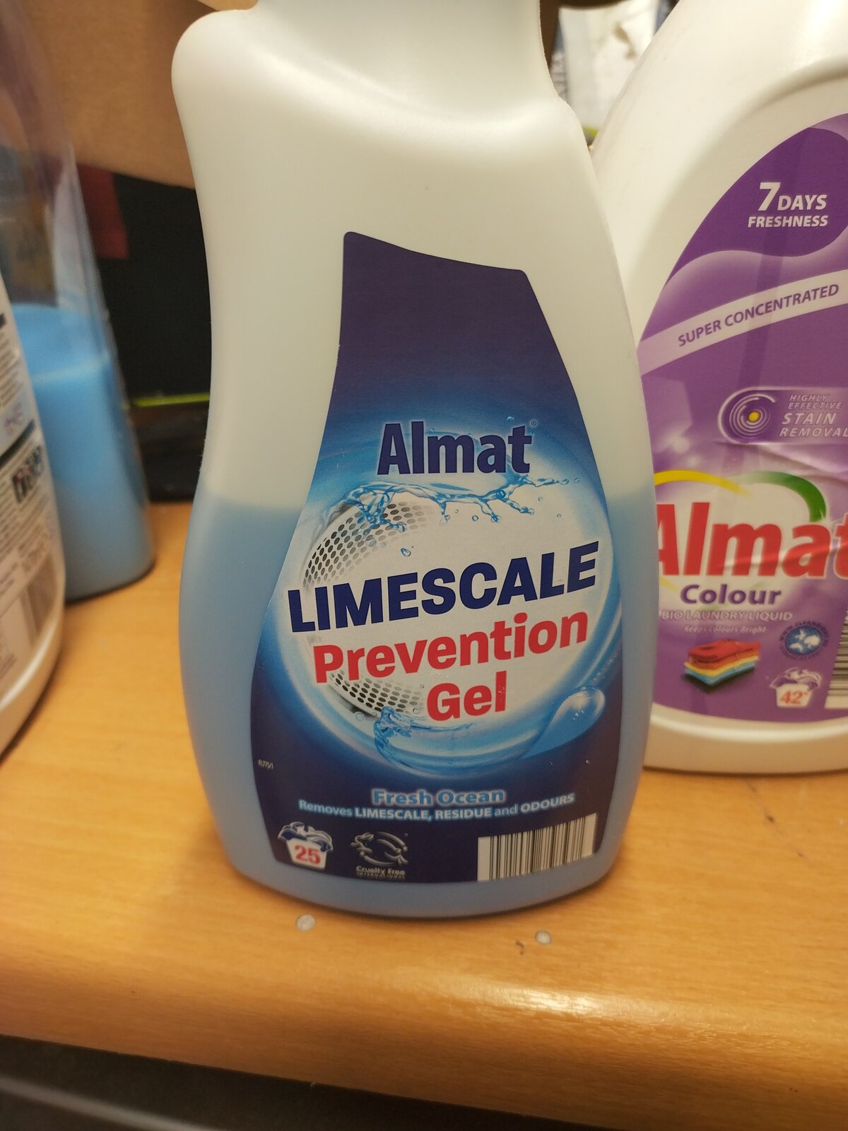

Guys, thanks for the replies. I've only just been able to take pics.
See below:
Total drop maybe 10cm.
More than happy to get hands dirty and take out the pipe and clean.
But... will wait to hear what you guys say first.
Not sure how I can best make drop and then rise 2/3rds - do I need to get extra pipe?
Thanks.
