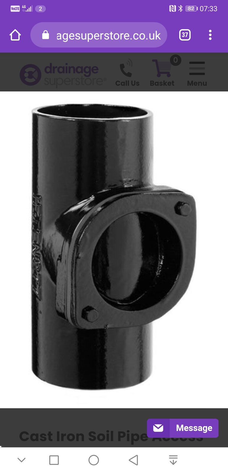

Do you mean removing the inspection/rodding cover and then getting a saddle that fits onto the flange and uses the bolt holes? Can't say I've ever seen one exactly like that.

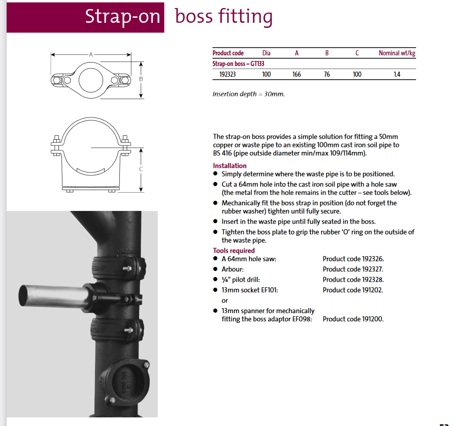

Not an option to use a normal 4" cast saddle clamp that will fit onto the plain cast pipe once a hole's been cored?

I'll get some photos but it looks like wastes have been fashioned into existing saddle plates on bosses... No strap on's or such like. There is no room for these to be added to the stack. It's a case of re-use the existing connection points.
