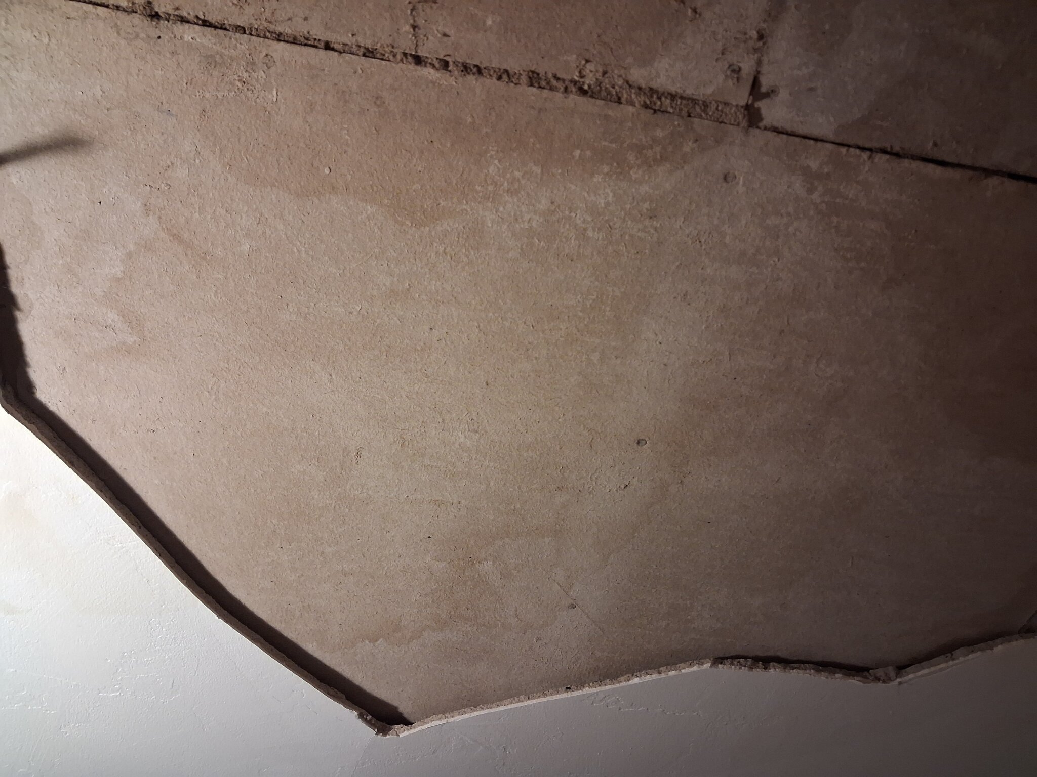

We had a water leak from the loft while working on the water tank, and the ceiling came down.
The question I have is, what is the bit exposed after the plaster has came off?
Could they be plaster board? Or some other type of boards? They look like card board to me.
What has come off from the ceiling is the outer plaster (which I put on years ago), and also a layer underneath the plaster, which looks like either the old plaster, or plasterboard (about 1cm thickness). There is about 1cm gap between this layer, and the boards exposed.
Then going back to the first question, what are the boards showing are? Can it be attached with the new plasterboards, and will they hold them if they were attached using the plaster screws? Because they look soft and appear to some cardboard type. They are drying off now, and I am waiting the work until they are totally dry.
In the beginning, I thought I could just plaster over the exposed area, and level it up for painting. But more I look at it, it looks like it won't work.
I need to attach some sort of plasterboard securely, and then plaster over the newly attached plasterboard to make it level, it seems to be.
I am just not sure if the exposed board can securely hold the newly added plaster boards with screws.
Dig a bit through paper layer with a screwdriver just expose the soft gypsum plaster behind the paper layer.
If you have no idea what plasterboard looks like call in DIY store and have a look.
Is the board level?
If so SBR and plaster skim over
The edges of the patch show the finish is blown plaster.There are no signs that from new the skim ever took to the plasterboard. Cant see much p/b nailing either?
Whatever you do you will have to re-skim the damage. So why not knock off skim back to bonded finish, and cut out a square of p/b as far as convenient joists. Then screw a new square to the joists or ledgers pinned to the joists. Noggins will be needed as well.

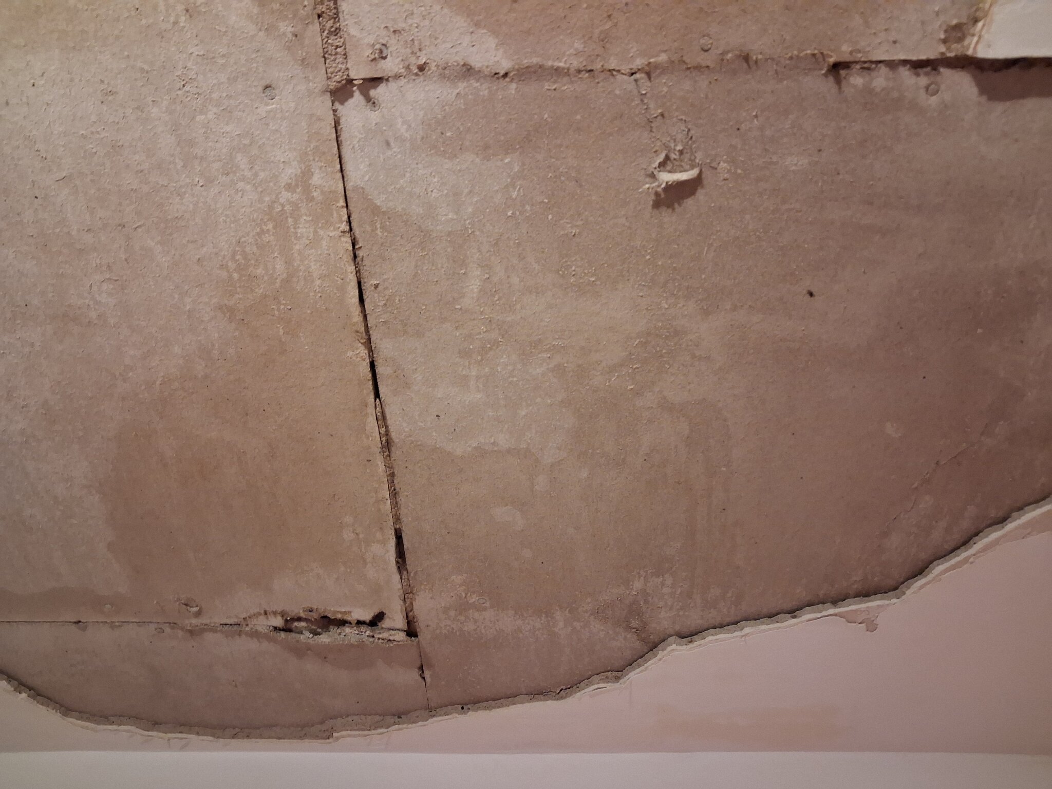

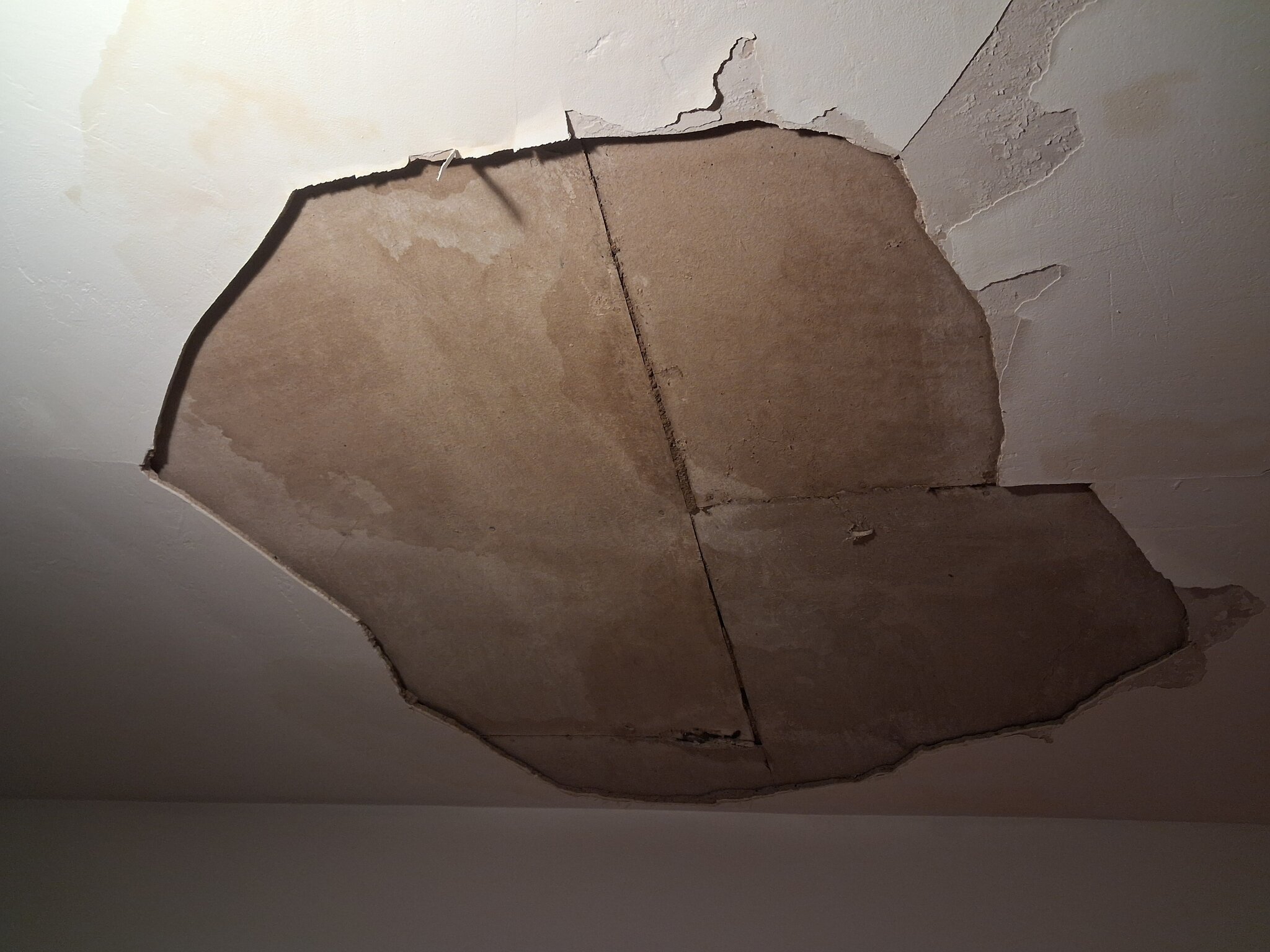

I have taken some more photos just now. Yes, the exposed boards shows no sign of plastering over them at all. They appear to be about 1ft width some boards joined by the nails. I could see the nails running along the lines where they are joined.
I feel they are not the plaster boards. The plaster boards on them seem to have fell off with the skimmed plaster. But I am not certain. What do you think?
If the boards were skimmed over, the plaster couldn't be detached like that flat and clean, could it? Do you seen the nails?
Plasterboard was like that around 50s I think it was.
Small narrow boards Vs bigger sheets.
Was a pain with all the cracks.
Building shortages at the time or something like that caused smaller boards were imported or was all that was available.
Don't know the reason just what I was told.
If you can push a screwdriver through easily it's plasterboard.
It either is or isn't but I understand you may not know what you are looking at.
Other possibility is fiber board which was used in 50s again because of shortages of building materials but that was more in prefab houses.
That's soft fluffy board.
Then you have the harder asbestos boards or cement board but that's rock hard.
You can also find hard board used which is unlikely. I've found that of DIY patch jobs
What do you think of the nails on the boards in the photos?
The boards are thin, and soft. When pressed with a pencil, it was making indentation. Through the gaps and cracks, what looks like asbestos is visible.

Could it be then, SBRed and plastered over it? It is about 15mm depth - (the exposed board surface and the outer skimmed surface). Thick SBR on the boards, and then thick undercoat, and then finally skimming would do the job?
It would be much easier just plastering over it with SBR, than trying to attach plasterboards on the unknown surface, not knowing if the boards can hold the new plaster boards on them.
