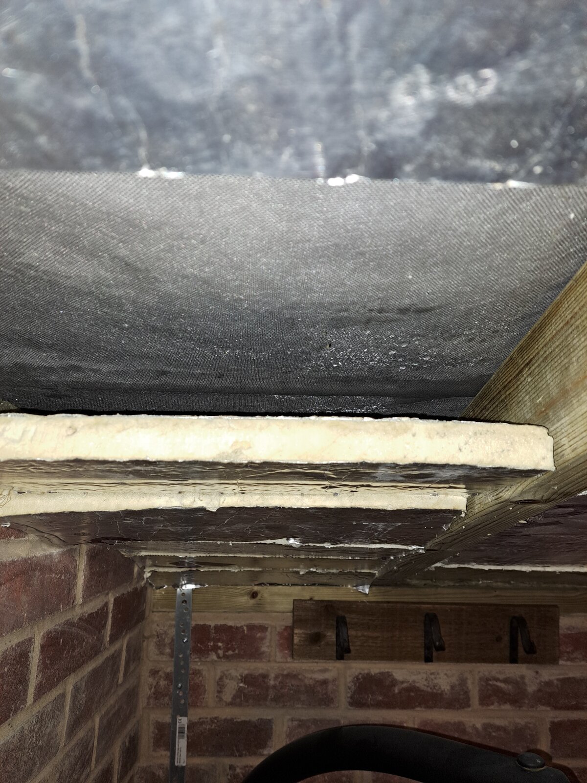

Hi any help apreciated, I have drops of water underside of my breather as seen on photo, the inuslation leaves a gap as seen but still water in this cold weather which then soaks insulation, how do I stop this?

Is that all the insulation you have in the roof? what is the tickness 50mm?
It should be, say, 100mm in-between the rafters, and 50mm under the rafters, and all properly gap filled and tape'd up, to make it air-tight.
It might be warm air (presume you have heating in there) rising and condensing on the underside of the breather membrane.
Yeah I think it is this as I dont think I have leaks above the membrane, 50mm insulation leaving 50mm, so if thats case do I need better vents above the membrane or fit a Water Vapour barrier over top of insulation then plaster or ply?
Think I would go down the eaves vents route firstly.
Then I would get a foam gun and foam the gaps for the insulation that is in-between the rafters.
Tape all the joins with aluminium duct tape.
I would then overboard the whole roof with more insulation, as thick as you can take.
I'm presuming your joists are 100mm? would have thought they should be deeper?
With a 50mm air gap that would explain why the insulation is 50mm.
If everything is taped this should stop moisture making it's way into the roof.
Have you got a pitched roof? if so, perhaps a dry ridge ventilation would be a good idea.
Good luck (y)

Thanks Mr Chibs, so the joints, gaps in the insulation between rafters foam and tape for tight seal. Overboard on top, can I use foil backing there and tape as could still screw boarding then to the rafters. Joists are 100mm, yes pitched roof both sides, eves first make sure flow goes over...
Morning, yes you can and should use foil backed... and tape.
Use as long screws as you need to to anchor into rafters, they don't need to be anything special.
You can use Wedi washers to anchor insulation/plasterboard in place, it will stop the head of the screw pulling through.
Good luck (y)
Good luck (y)
Morning, agh good advice thanks, so you wouldnt recommend aliminium roll on top as oppose to thicker kingspan...?one daft question I thought the eves insulation was the air flow above the membrane and not under it too as that would be inside the build that correct, so just above?
Aluminium roll? Are you talking about the space blanket foil quit malarkey? If so, I wouldn't.
Eaves vents, go under the membrane. When you make the insulation air tight, warm air from the roof will not be able to reach the underside of the membrane and condense into droplets. The eaves ventilation will allow any moisture to be carried away.

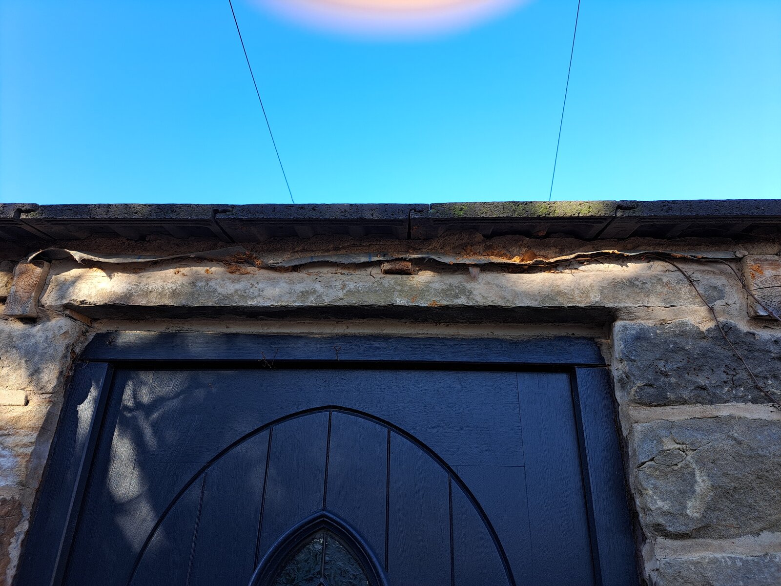

Take a photo of your current fascia, so we can check what you currently have i.e. soffit vents?
One or the other, you don't need both.
You don't need any ventilation for above the membrane.
Hi I think I see the issue now you have pointed it out that the membrane has no air under on the edges, so clear out under there and add some vents, same for both sides that about right?
