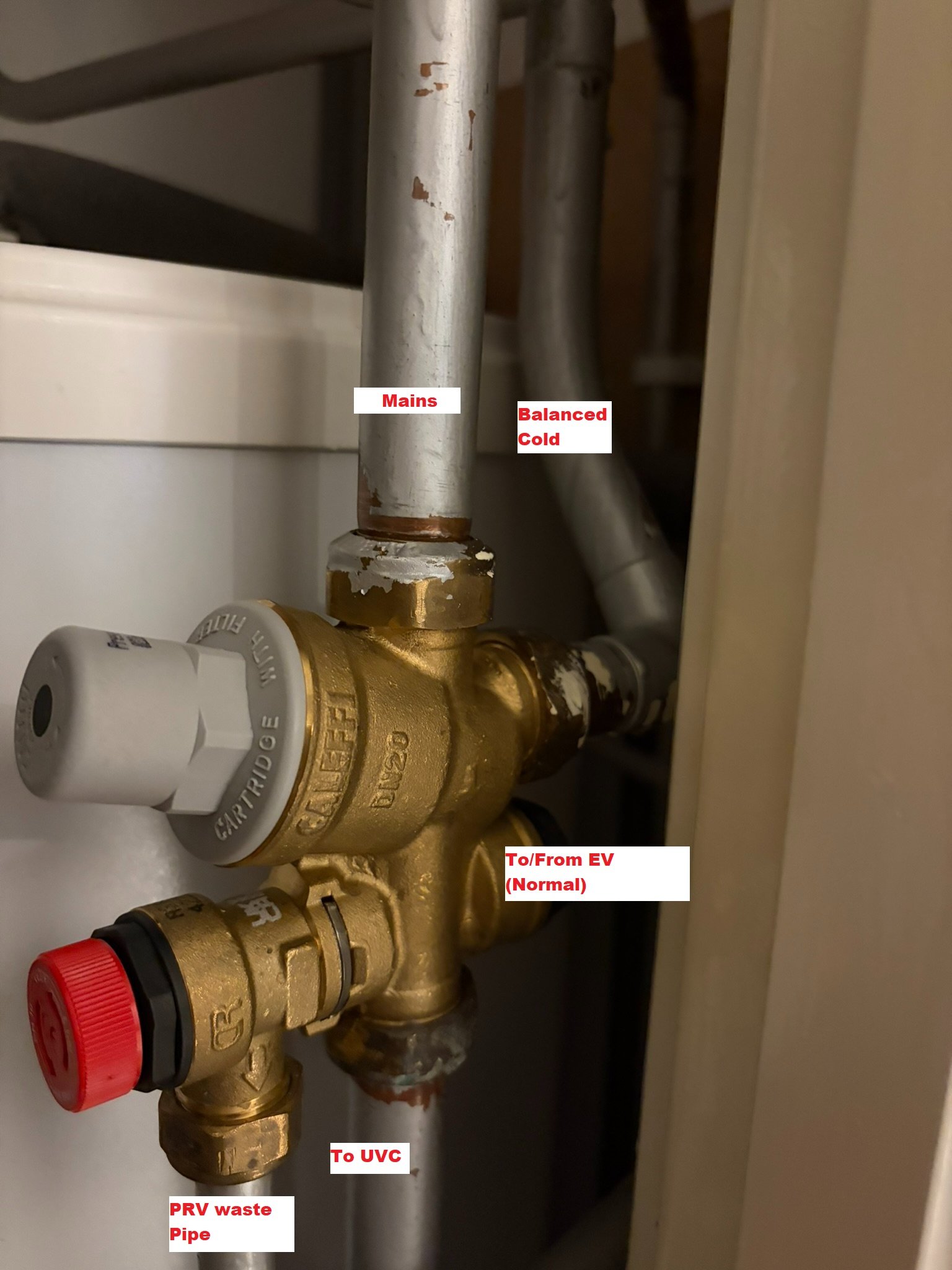

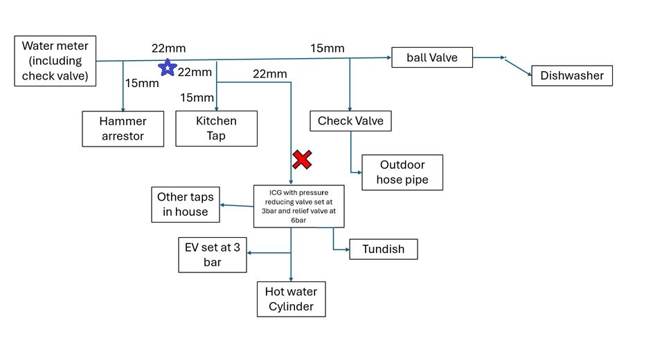

Just to recap.
Original install: Only one (ICG) PRV, cold taken off the balanced ICG port, but EV take off from a T downstream of the ICG and not from the port on the ICG.
Don't know if the system worked OK for 6 months or so? before water hammer, but a PRV was/is installed upstream of the ICG.
Piping mods, in no particulr order.
Remove the upstream PRV and install a T piece with the take off blanked and reposition the EV take off to the ICG port, but this probably requires a G3 to do so?, so maybe last option, the present EV take off should be fine as its downstream of the ICG check vave, Caleffi have also confirmed this, but who knows, this change should probably be the last throw of the dice.
As above but reposition the PRV on the T, remove the cold from its balanced port, blank the balanced port and installl the cold take off from this PRV.
If no cure, as above, but then reposition the Balanced Cold & the EV pipes to their ICG ports, the system is then exactly as designed.
Present ICG piping, the EV is piped off a T downstream of the ICG.

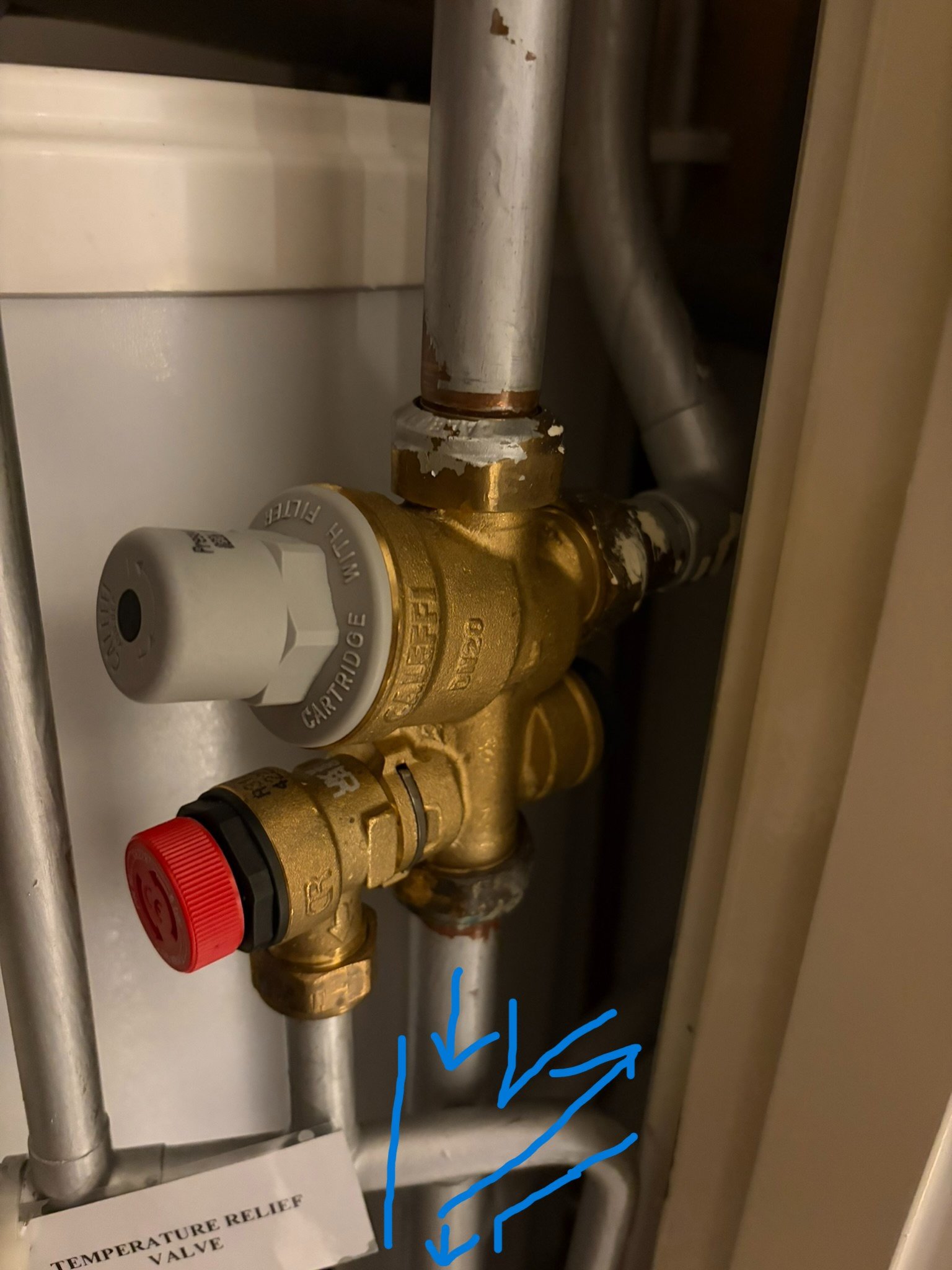

Any work to do with the UV safety devices should be performed by a qualified engineer that would include the main EV. The EV take off positioning is fine on the cold feed to the cylinder, as it's there to absorb expansion from the HW cylinder, it doesn't have to be from the take off point on the group. It can even be on the hot draw off side if space is a real issue, though that's not ideal.
I am not suggesting any major changes - one thing at a time IMO so it's known what the single cause is.
All I am suggesting is cut a tee into the mains above the Group. Disconnect the balanced feed from the group outlet and cap that outlet. Then take that tee's supply from the main and connect it to the balanced cold supply pipe. Leave everything else as it is. Then run the same knock tests as before.
