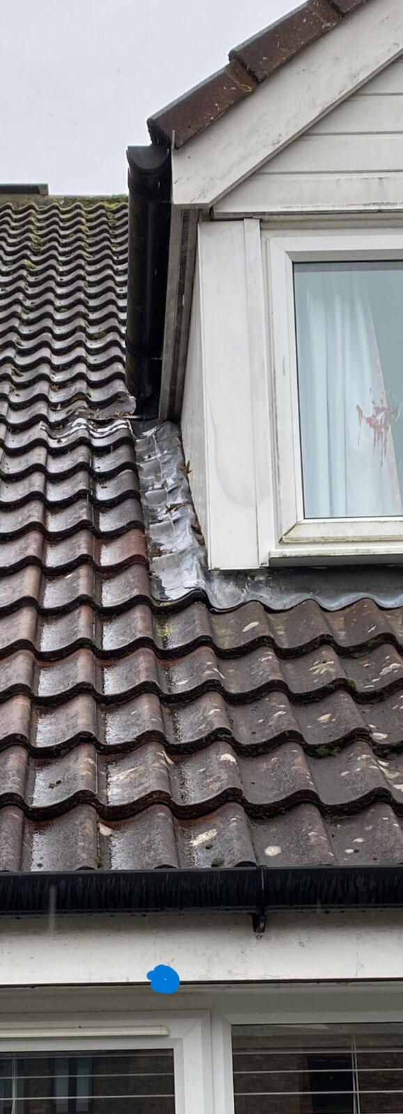

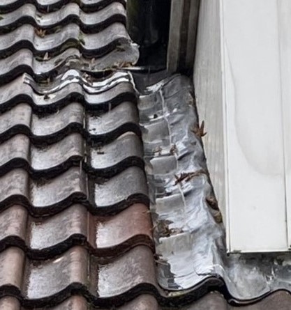

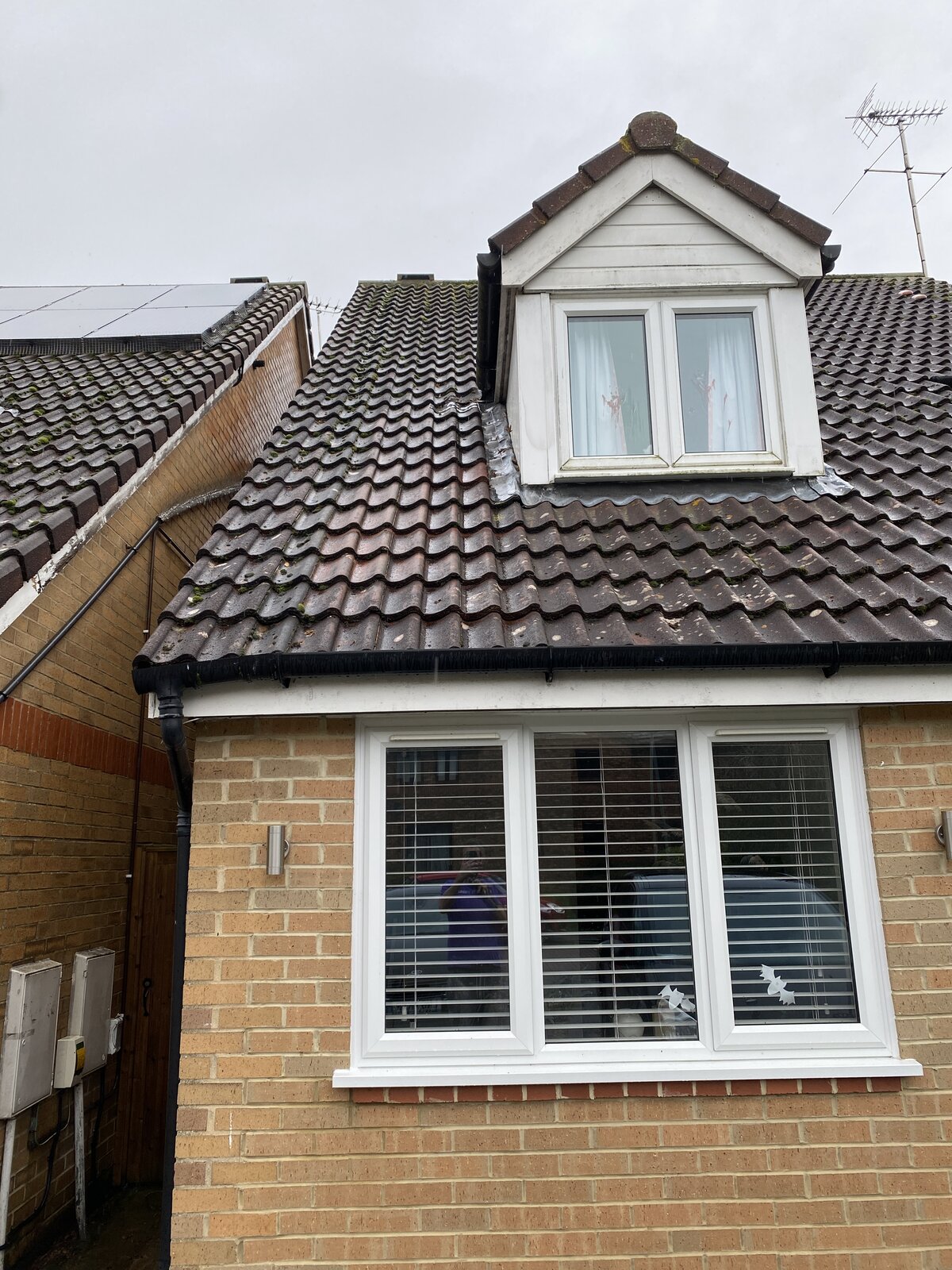

Hi,
Just after a bit of advice regarding a leak I have.
See attached photos, in January I had an issue where water was leaking into the room below. the lead was extended and sealed, and all was ok.
I have now noticed another issue, with heavy rain I am getting water dripping through the soffit, where the blue dot is on the photo.
The water is then leaking into the front of the room.
Just wondered what is more likely that it is leaking somewhere further up the roof and coming down the felt into the soffit or somehow leaking in the front 2 rows of tiles. Gutter seems to retain a bit of water so slope might not be ideal but wouldn’t of fought it’s enough to overflow into the soffit.
Deabting whether to get up there myself and see if I can see anyting obvious or get a roofer in.
Many thanks

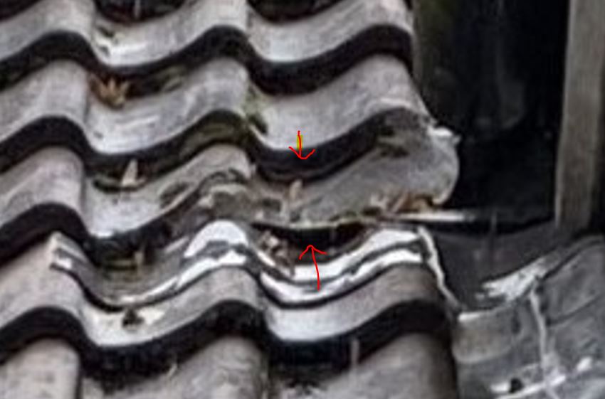

It was my first thought; sliding a couple of tiles up so the felt is visible would let you see potentialls see water trails on the felt, or sprinkle some powder paint in there to see if it tints the drips. Could be an issue with the flashing at the end of the dormer valley
You can check the gutter function with a hose if you can't wait for rain

Mulling over if I should get involved myself or get someone in!
Also, have had water come down the outside brickwork on the left of the window, below the outside sill.

Would the first row push up or be nailed?

Try the second course .
Flashings look a mess and Likley the cause .
Get it done properly and forget
Many thanks, like you say, might have to just get it done professionally but just trying to save money where possible if it’s something I can have a look at myself,
With tiled roofs if the course you want to access is nailed, you find a course further up that isn't nailed, push up to access the nails of the lower course(s) and then remove the nails/tiles to come down to where you want to access
