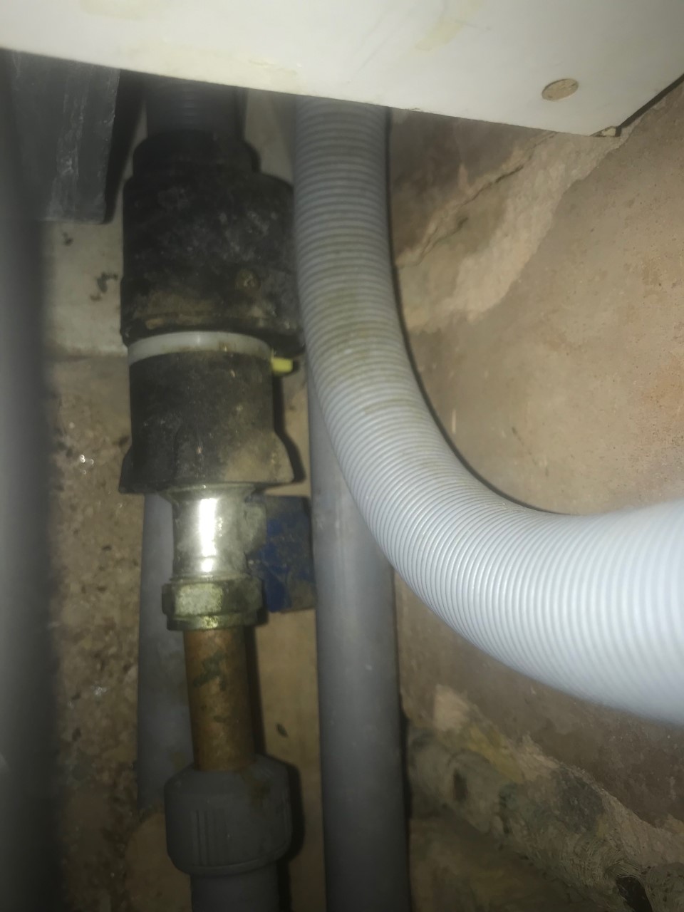

My problem is the unit is too tall to fit under the sink. If I move it somewhere else it needs additional plumbing and I will loose a valuable storage space. I will post the pictures of the kitchen later today. I was checking the plumbing yesterday and I found the mains pipe. What is this valve in the picture? Closing this didn't stop the cold water.
Looks like a washing machine valve (blue handle) with a "flood stop" washing machine connector above it.
Your mains input is much more likely to be controlled by a stop c*ck (look it up on the internet), but it could be a lever valve.

My problem is the unit is too tall to fit under the sink. If I move it somewhere else it needs additional plumbing and I will loose a valuable storage space. I will post the pictures of the kitchen later today. I was checking the plumbing yesterday and I found the mains pipe. What is this valve in the picture? Closing this didn't stop the cold water.View attachment 170745
I had oneof them, it broke within a year, truly crap.I ended up with a Monarxh dual softener, excellent quality.
I dont think its a washing machine valve as the kitchen tap copper pipes connect to it after this valve before the washing machine.
