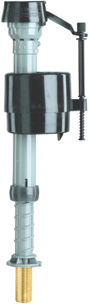

Maybe a stoopid question but I get the impression that wc,s have a half inch connection. Why is that when all pipework going into it is normally 15mm. ? Why don't the manufacturers make a wc with 15mm connection? Perhaps some do.
The connection is half inch BSP thread - it was like this when lead pipe was used, then half inch copper. ;)
Ok, thanks I get that but things have moved on , why cant any new wc,s be designed with a 15mm connection?
You need to connect this
98683_P
to this (or equivalent)
ae235
The thread on the fill-valve is 1/2" BSP
There's no advantage in changing the 1/2" BSP to a metric thread (and quite a few disadvantages - two versions of every fill-valve or two versions of every possible connector)
This is soldered to your 15mm supply pipe and enables you to screw the pipe to the inlet valve on your cistern

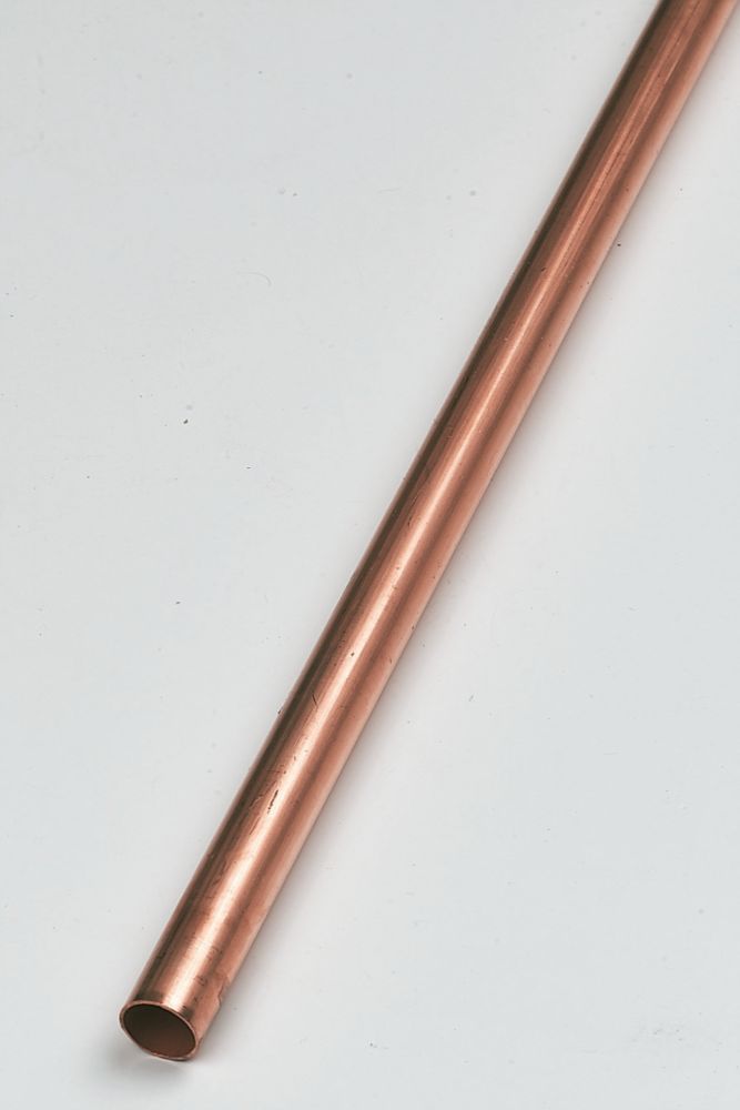

When did copper change from 1/2 inch to
15mm, early 70's?
Usually basin and sink taps are 1/2" BSP and bath taps are 3/4" BSP
15 mm copper and 1/2" copper are (pretty much) interchangeable. 3/4" and 22mm tube isn't.
The 1/2" on the pipe size refers to the internal diameter (bore) whereas the 15mm refers to the external diameter.

Yes, standard washered basin and bath taps are 1/2" and 3/4". The pipe is joined to these taps using either a 1/2" or 3/4" tap connector.
Copper did change in early 70s, NigeF is your man for the exact year, month and day. ;) Unless he was on strike that day. :)
The 1/2" connector used with a fibre washer to connect to the toilet fill valve in NotSoNewBoy's post is actually a 1/2" tap connector. Although some people seem to use 15mm compression fittings occasionally, I believe the tap connector is actually the correct way.
