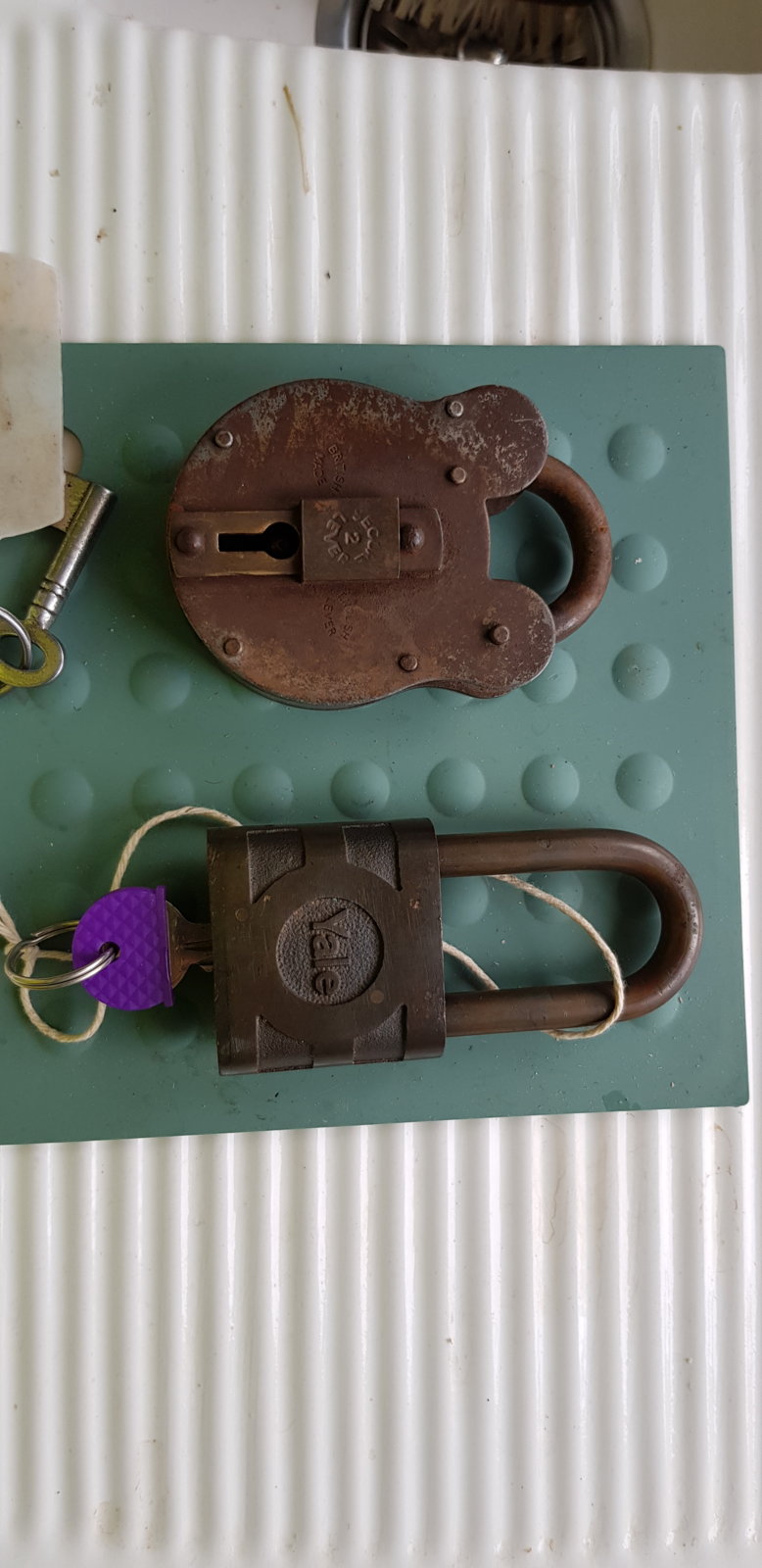

I have a friend who is a locksmith and he gave me a marine padlock. He said that it would never sieze. I have two padlocks that are forty years old and they both work like they were new.padlocks.jpg

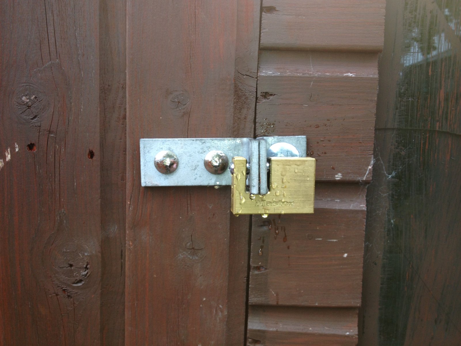

Have had this on my shed for a number of years now without problems from B&Q. The occasional squirt of WD40 always helps. ;)
