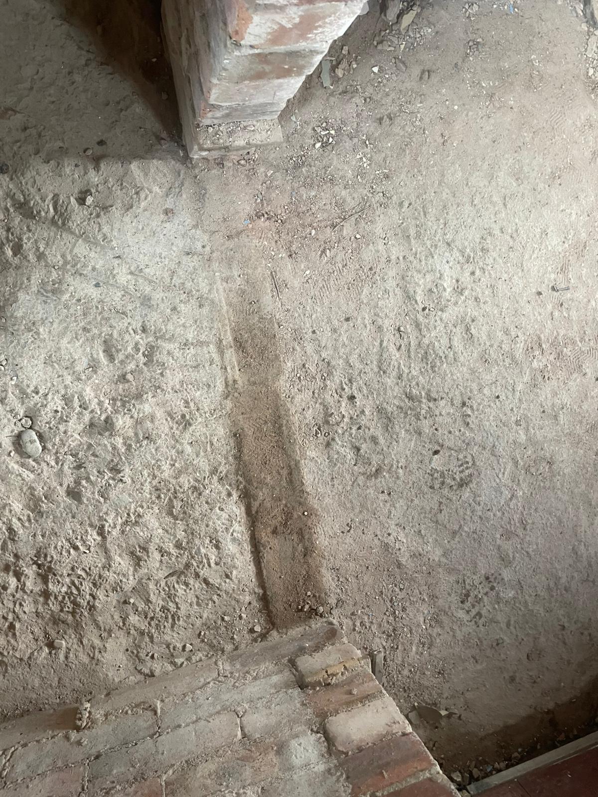

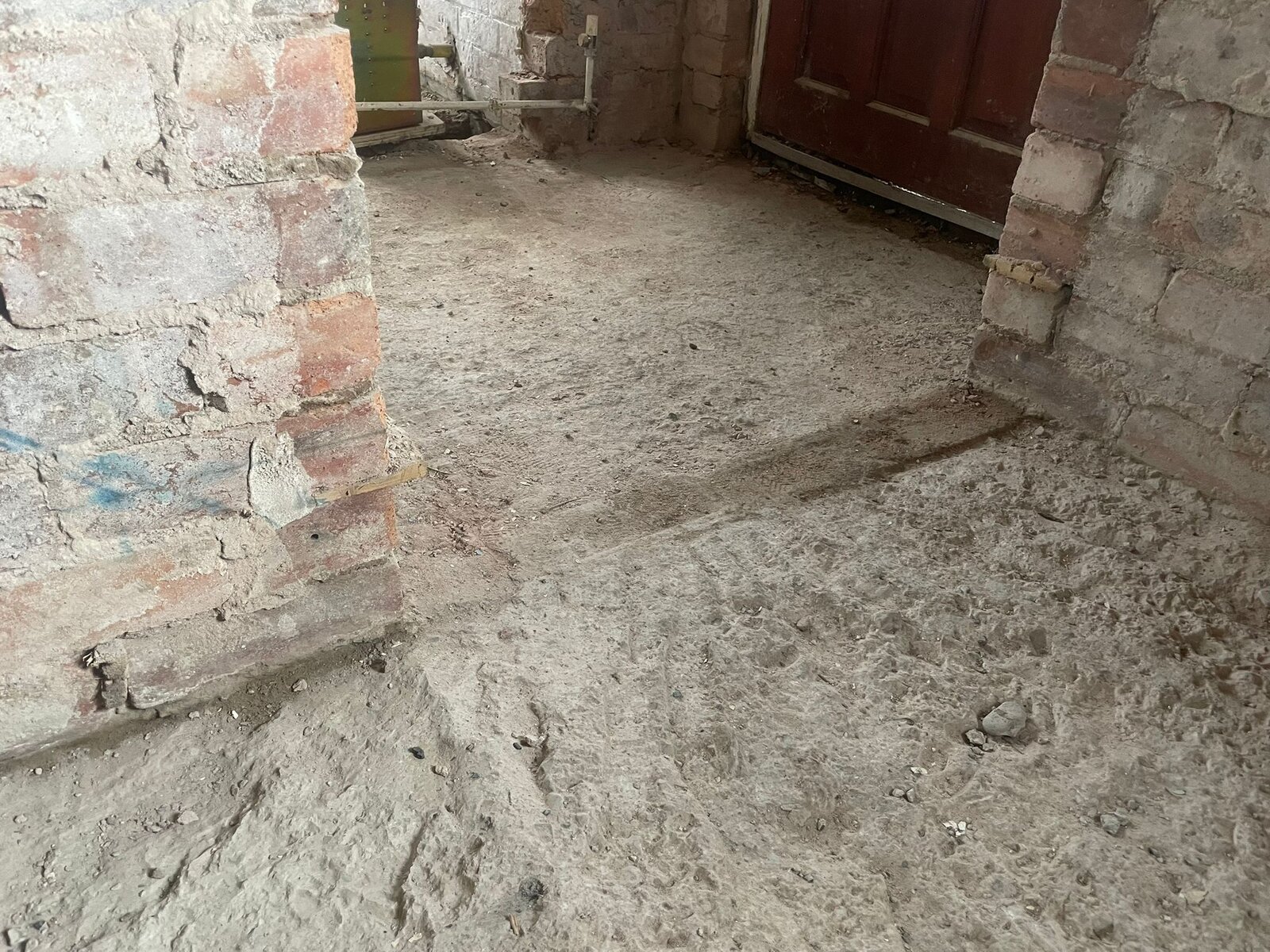

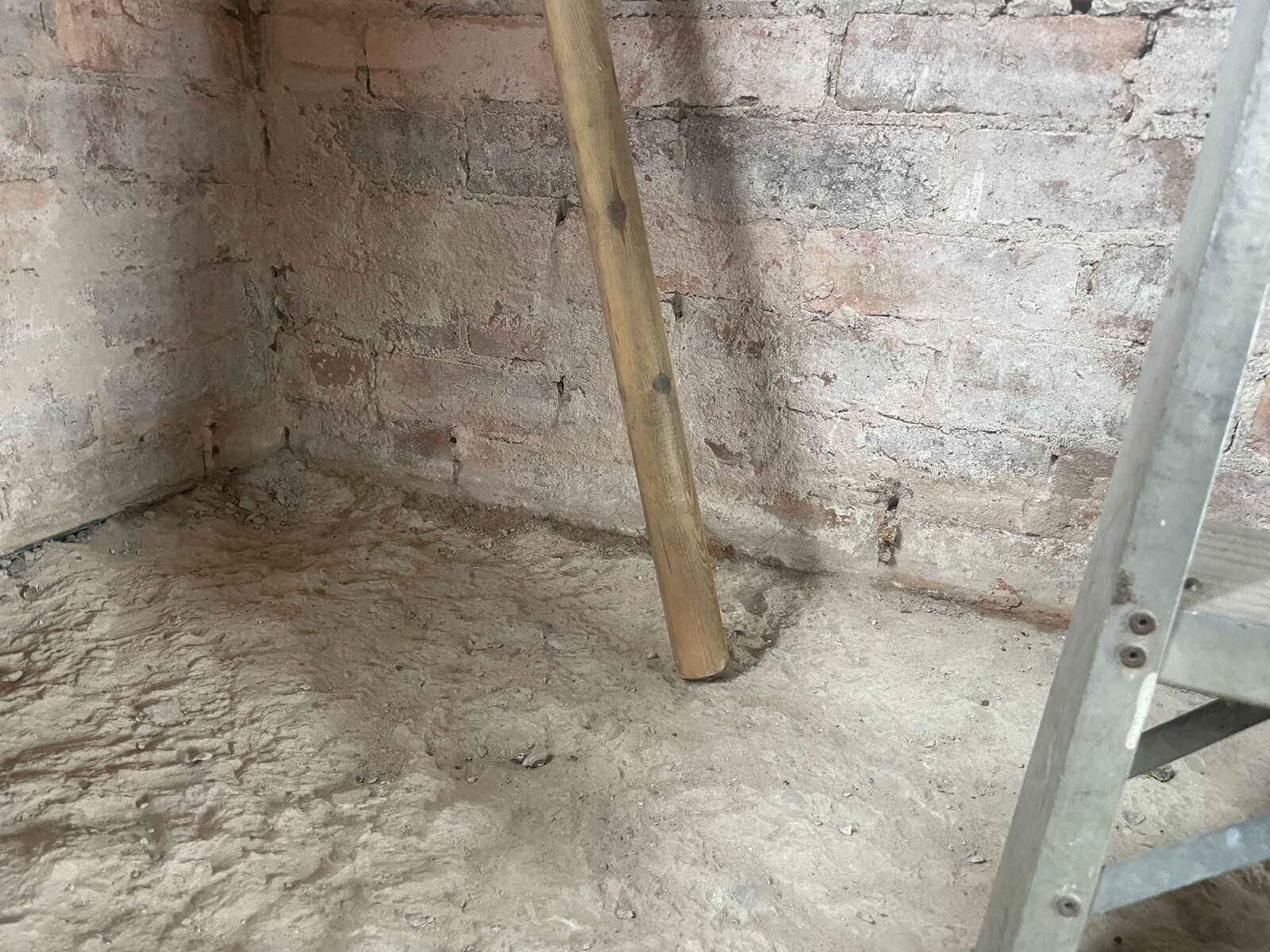

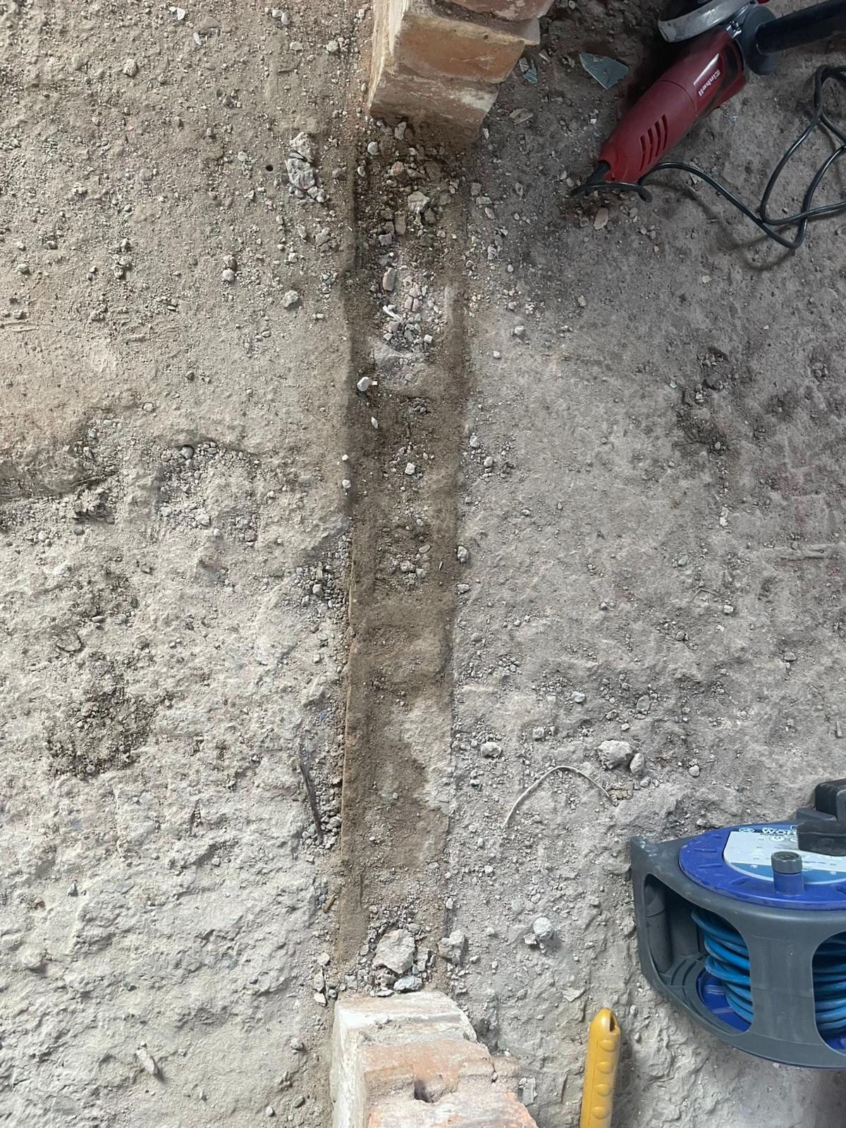

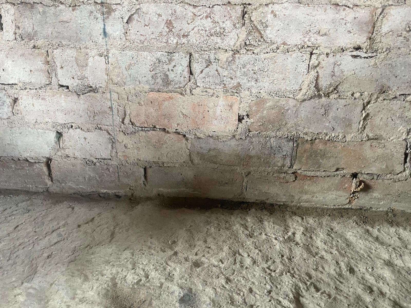

Hi, Im renovating my house and I've chipped the plaster off the internal walls and chipped down the concrete floor so that I can add a layer of insulation on the floor, I'm going to self level the floor then add the insulation panels. But I've ran into an issue, along the floor to wall corners are slightly wet/damp, the same with the bricks in the floor where the doorway is. What should I do about this?

Is that the dpc I can see in the first picture?
Anything under dpc will be damp.
You should have plastic dpm under that concrete floor and up to dpm at the edges.
Outside 2 courses of bricks above ground to the dpc.
Looks like water is getting in under dpc with nothing on the inside to create a barrier
You're correct, dpc under the bricks.
Correct with the rest too, is there anything I can do to create a barrier between the dpc and the concrete without breaking up the whole floor?
