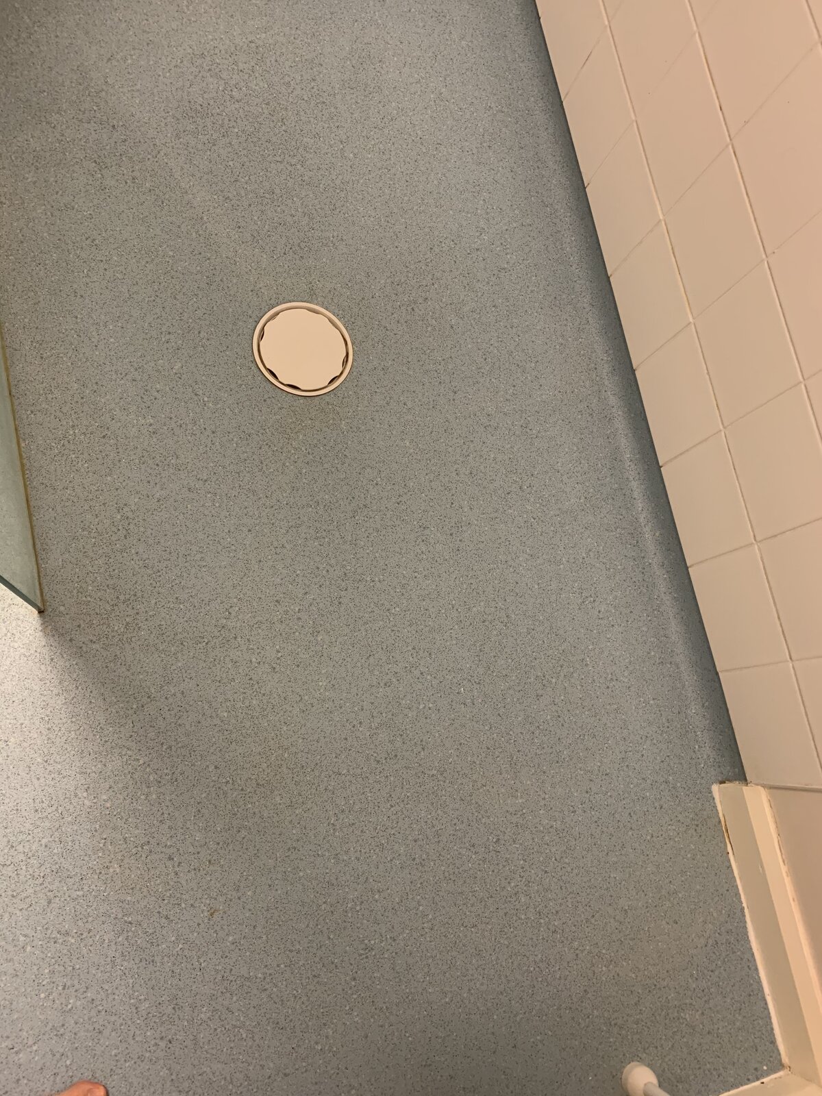

I've decided to bite the bullet and start on the wet room. I've been putting this off now forever because of the flooring. I'd like to lift it and have similar but nicer flooring laid but have a few questions first.
1. Is it vinyl?
2. Who would fit such a thing; is that a plumbers roll?
3. I'm imaging it would be hard to lift - is there a neck to it? How is it usually lifted?
4. Where could I purchase new stuff?
As you can see, I haven't a clue about this hence why I've left it to the stage I hate looking at the room. I'd like the flooring to come partially up the wall were the skirting is to match the rest of it and to remove those horrible tiles. But need to find out about the floor first.
It's Altro safety flooring.
It's glued and welded.
Usually flooring contractor job.
Lift it using a floor scraper and multi-tool with appropriate blade.
You can also get other brands and styles.
Tarket is one I know of.
