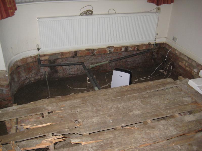

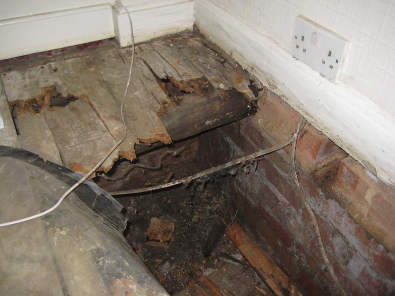

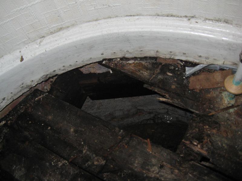

I have a wet rot issues with the joists in my living room. As per the pictures they are damaged and the floor has dropped. Floor is normally covered by laminate. My house sits lower than the road and the driveway slopes towards the house. Looking under the floor I can see some slight wet/damp patches. I was visited by a damp company and confirmed that it was wet rot and just the timber needed to be replaced without any treatment.
Can anyone give me some advice on the following:
1) Should I spray some wet rot treatment on the new and old timber to be safe?
2) What is the best way to attach the new joists to the masonry wall? Joist hangers, timber in brick, hang off ledger beam?
3) What is the best way to join the new joists with the old ones?
4) I have read that it is best to cover the ends and the ledger beam with DPC. What is the best way to stick this to the wood?

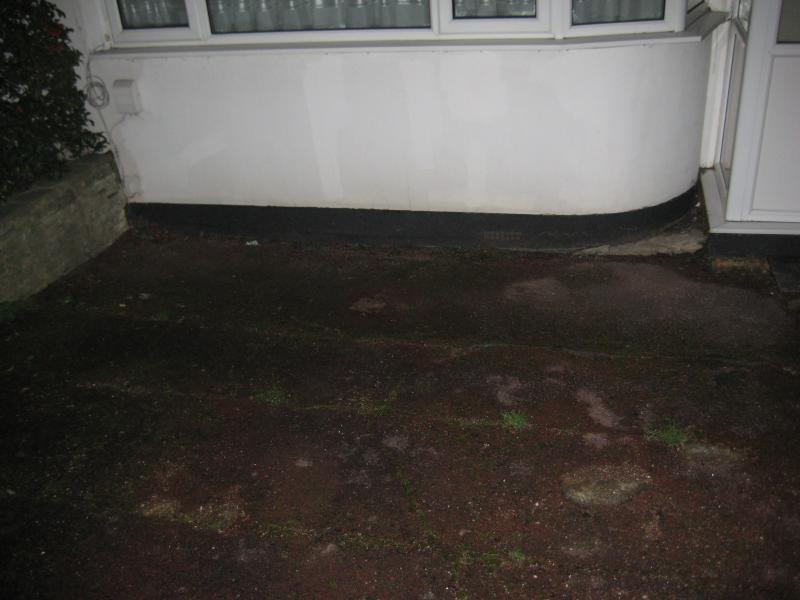

5) How can I prevent the natural ingress of water from the higher driveway under the house. The drive level is below DPC but the driveway is very old tarmac and will be replaced soon. IT has surface cracks which is why water may be travelling down.

Before you or anyone else do anything you must be pretty certain as to what is the cause(s).
You will have to lift more boards to expose the floor joisting in the bay, and perhaps further out into the main field of the flooring.
Post more pics when all damage is exposed.
Bolt-on repair joists are best practice.
The rad will have to come off the wall, and the skirting be removed because it is probably rotted on the back.
All the plaster below the window board might also have to be hacked off.
At the right hand side of pic 1 i think that i can see white dry rot strands.
You will need some new 10" x 6" vents. Post pics of the front of the house and driveway.
You might need channel drainage.
The plinth is possibly bridging the DPC, and is in ground contact.
Dont seal or inject anything.

My driveway is on a slop towards the house so I suspect that water may be running down as there is no channel drain present. From the marks on the inside wall it appears that water may is getting into the vents?
There is a small drain present but it is not that good,.
I think I should get my driveway replaced very soon as the current one is shot.

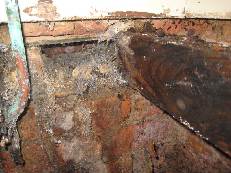

The vents are above the DPC but the joists go into the same hole so they partially obstruct the vent? Is this right?
I think I should gets some new vents fitted next to the old one away from a joist. Should I go for standard brick vents or those L shape ones?
There is no plinth as the joist are direct in a hole in the wall. They were completely soaked through. When I fit new ones I will wrap them in DPM. Any particular type that I should use and how far in from the end do I need to go?
Wall is not a cavity wall. Joists are above the ground level and the same height as the vents.

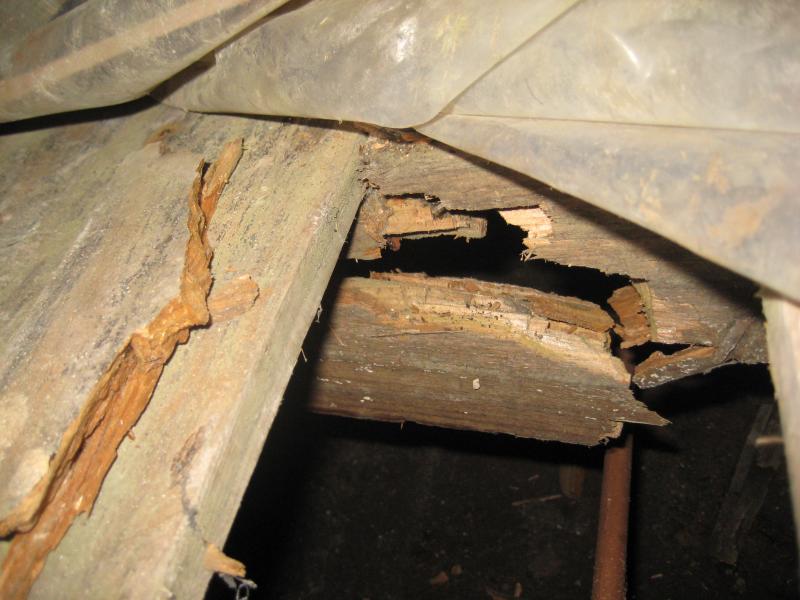

They said the following:
The following infestations and infections were noted:
WET ROT FUNGUS - (CONIOPHORA PUTEANA)
Isolate plates and joists from brickwork with damp proof course felt.
The external ground level appears to be high and possibly bridging the damp proofcourse, this may lead to dampness penetrating the brickwork. We recommend client's own builder lowers external ground level to at least 6" below damp proof course level.

1. the exterior requires channel drainage across the whole front elevation including the porch and on the left to the boundary point.
The stone abutting boundary or "planter" wall must be pulled back from butting the house.
Do this before any new driveway. Again, search for "How to do it.."

2. Introduce say min. 3 new "standard" 10" x 6" air bricks. Dont allow the joist tails to block them.
3. There should be no ground contact with the external plinth or render.
4. The plate below the joists must be entirely removed - do it in sections.
It will be rotted out. Make good with cut brick.
5. Given that the bay brickwork is solid then you will have damp penetrating to the internal plaster and skirting!
6. The green corrosion on a copper pipe - what is this pipe supplying?
7. Paste the joist tails with a "mayonnaise" anti-fungal, and wrap and cap with DPC to about 6" or "8 back.
Thoroughly clean out all ex-timber pockets.

I'm only a DIYer, but at a guess, the main problem you have is in the driveway there should be a slope from all directions into the drain, it doesn't look like there is (I may be wrong) Possibly the drain is blocked too - open it, put your hand in a black bin back and stick your hand down it clear out the crap if you can. Water has been for years (since the driveway was put in?) been collecting against the house and seeping into the brickwork.
My driveway ground level is a few inches from the DPC, what I've done when I put my drive in was leave a 6 inch channel all round the house and fill with shingles. It allows water to run into the ground and keep away from the house.
Getting the driveway / drainage sorted, or at least the flat area at the bottom should be high priority.

*and yes agree with previous poster - why are you ripping up your entire floor! doesn't look like T&G, you should be able to pull up the odd floorboard if you want to see the state of joists in other areas
I stand corrected. They are square edge floor boards not T&G. This suggests to me that previous work has possibly been done to the flooring.
Unless square edge was a joinery practice in that district.
