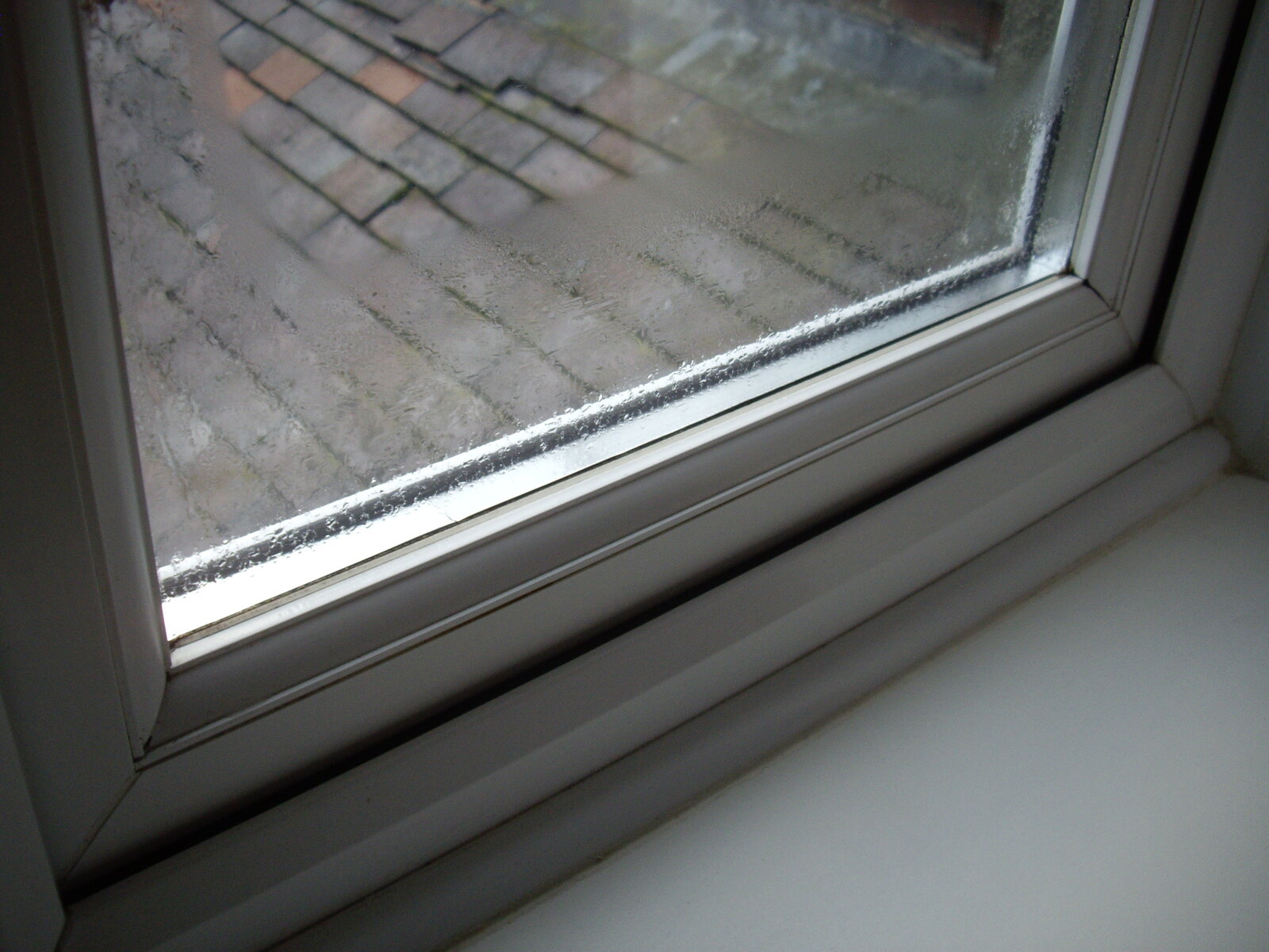

I'm finding a lot of condensation around the bedroom window as the nights get colder - we had new windows fitted with trickle vents and they're clear so i asked if the older windows could be fitted with them and was told not. Is there a way of reducing the amount of water around the window every morning rather than leaving a cloth to sop up the excess water?
See what i mean?

Probably just breathing and insufficient ventilation. Open the bedroom window in the morning after throwjng back the bedclothes so they can air.
You could open the door a crack or open the window the smallest amount overnight. But check other rooms early in the morning.
If there is a source of damp in the house such as a bathroom without good extraction, or wet washing draped around, fix it. Less often there is a tiny leak from a radiator or water pipe.

Trickle vents don't stop condensation. Simply not enough fresh dry ( cold in winter) air coming through property.
Run a dehumidifier for 4 ish hours every night is one answer. Worked for us.

That rather depends how much water vapour is being added to the inside of the house, and how much is being ventilated out.

in general do not dry clothes indoors or shower or bath without bathroom extraction greater than moisture generated along with kitchen extraction greater than moisture generated and with trickle vents normal breathing and household activities will not be a problem unless damp from other sources like leaks or rising damp exceed the amount than can be removed by passive ventilation
Usually straightforward to retro fit uvpc vents. No guarantees it will prevent condensation but should reduce it.
