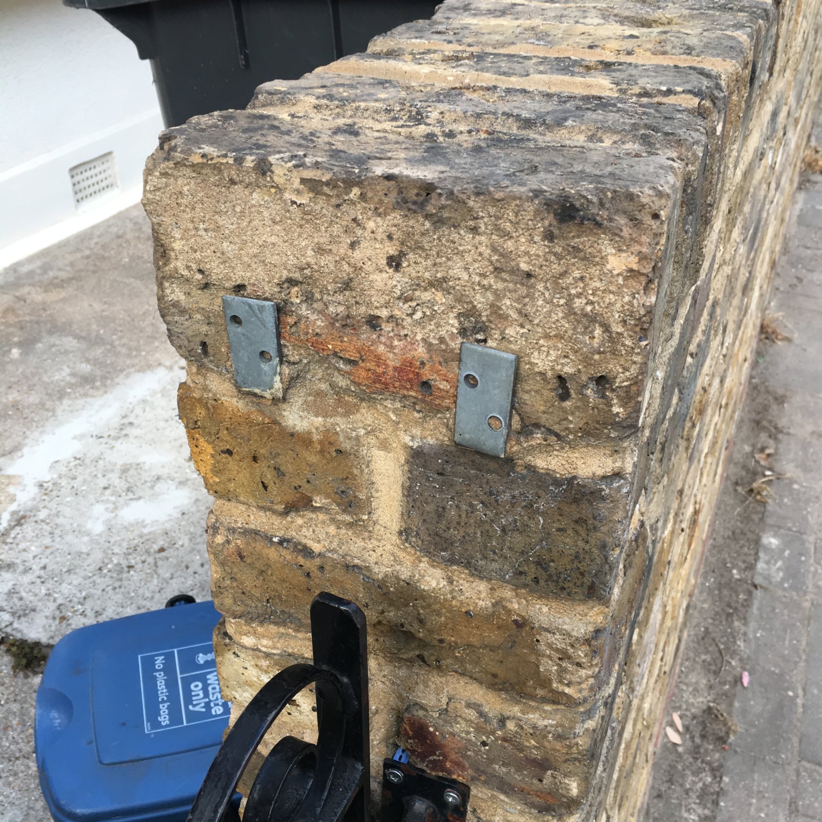

What are these brackets in the ends of walls for?
31 Jul 2008
63
You see them all over the place. Are they the ends of reinforcing bars or something like that?
it's an attempt to prevent the end brick falling off the end.
Its stops the last brick from being chipped off. The end brick is weaker because its only joined on one side.
They are frame ties - as said to reinforce the end brick.
You could get some more decorative cramps in the past, but I have not seen any around for a long time.
