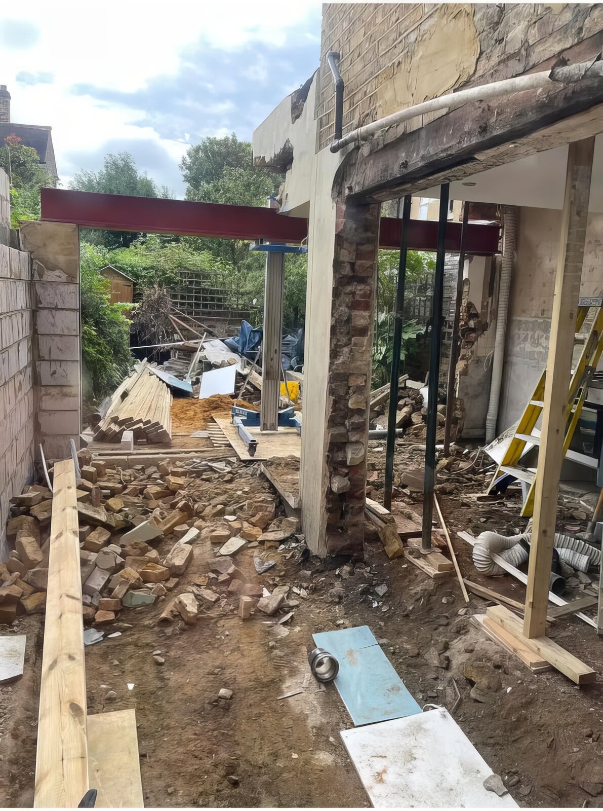

My sister recently had an extension done, to what I believe is a terrible standard. Aside from an unbelievably shoddy finish, the main issue is structural. Rather than the usual cracks that appear when you slide in the RSJ, her entire second floor has 10-25mm cracks all the way through the brickwork (not plaster), running around the perimeter of the two rooms above it. Literally as if completely detached. I don't have pictures unfortunately.
What I do have, though, is this picture, and I'm wondering if any experts can tell me if anything particularly bad jumps out at them:
Would appreciate some feedback
Thank you!
Is this one of those test where you spot as many things as you can that are wrong with this scenario....
1) the right hand side of the RSJ not being sat on a padstone
2) wall under said RSJ is damaged
3) wall beneath left side of RSJ has no bond and is just block on block
4) no padstone visible, just looks like it has been rendered
5) Genie lift is sat on a flimsy pallet and a sheet of OSB
6) there is a large chunk of unsupported masonry above the Genie lift
7) planks and a 4 x 2 holding up whatever is above instead of an acrow
8) Substandard pads for the other acrows
9) Where is the footing below the existing wall corner ?
10) Rubbish and crap everywhere and badly stored materials.
It is a Health & Safety Officers dream and it would be shut down in a flash.
Thank you! I suspected as much. I'm not an expert, but having done a lot of my own work, I was pretty sure the things mentioned in your list DAZB were present in the picture. Just had to be sure. Really appreciate you taking the time to be so thorough.

DAZB: regarding point 7, do you think that might be responsible for the split? Directly above that bit of wood is the bathroom. I assumed the crack appeared when they dropped the building off the acros onto the steel, but now I'm thinking it might simply be a split caused by the floor bearing down onto that 2x4?

I doubt that the 4 x 2 is responsible for causing a split as bad as you describe and more likely the overall bad quality and workmanship carried out by people who appear to have had no clue in general has contributed to a very bad finish and, what sounds like, unresolved structural issues.

there’s a difference between lack of support whilst installing steels and steels not correct and not on a suitable bearing.
Mind you the image doesn’t give much confidence the job ended up compliant.
I have no idea what a fix looks like in that scenario
If the foundations are ok then a fix probably looks like exposing the steels and their bearing walls, supporting everything whilst those areas are rebuilt.
If the image is an indication of the resulting structure, I can see £5k disappearing remedying it easily
