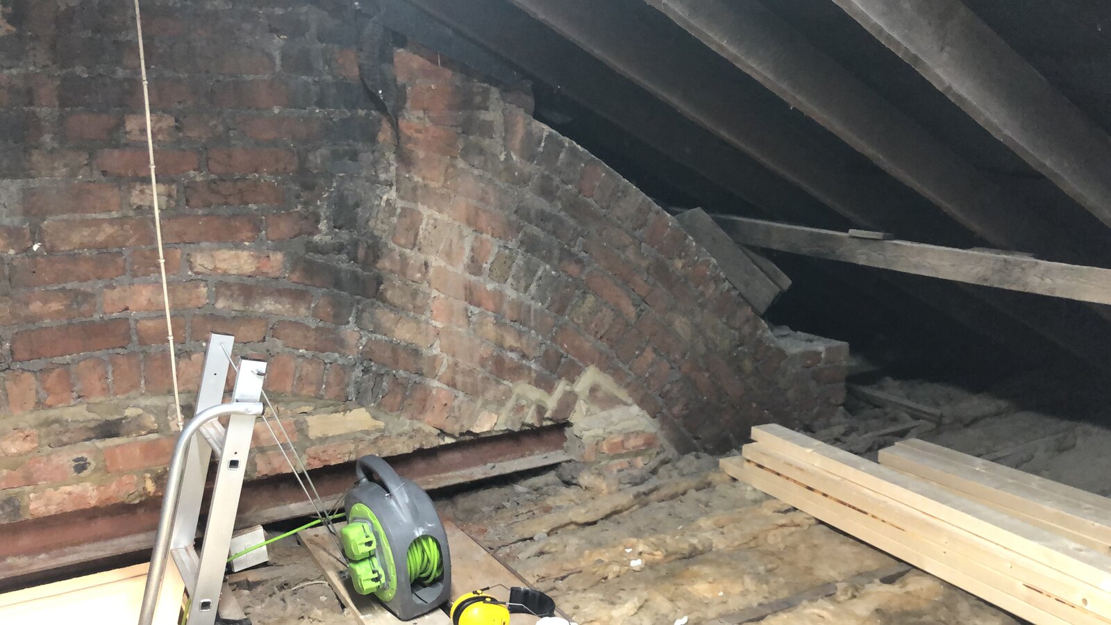

What do I do with crumbling bricks in loft?
I'd put a 50/50 mix of SBR/water on first (to encourage it to soak in) then slap a second coat on neat.
It will be like milk on the first coat, cream on the second. It will definitely stick everything together.
My guess would be that they were just rubbish bricks, intended for internal use where they were going to be plastered over.
Whether you do or don't put a slurry over it should be decided after the SBR. My bet is it will probably be pretty tough at this point and won't need it, in fact you could create more problems by putting a surface over if this then starts falling off.
But, if you do want to render it then the SBR will be the perfect primer anyway, you've done what anyone rendering a wall should do first anyway.
I've bought some Everbuild 503 SBR and will apply this as you've recommended. If it indeed does hold the wall together completely with no further crumbling then I might just leave it at that because I don't mind what it looks like as long as it stops chucking dust down the loft hatch onto the cream carpet! Will report back with how it goes, cheers!
It will look just the same but wet and shiny looking, with a bit of a weird purple tone to it.
Everbuild stuff is absolutely fine, and usually the best price going. Their parent company is Sika, I suspect the Sika branded stuff is exactly the same for a higher price.

Per yourself and RrogerD I might give this SBR a go- thanks. Worth noting though that I did already try to use a vaccum it and the vaccum started taking whole chunks out of the crumbling bricks. It's to the point where I reckon some of those spalled bricks could be removed entirely with the vaccum cleaner - and I'm not exxaggerating!
