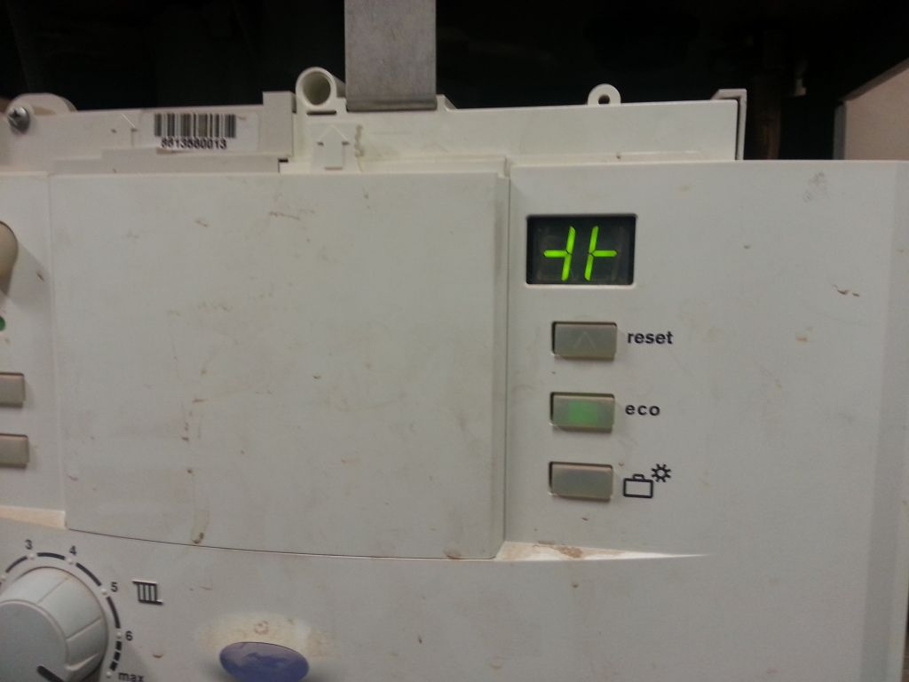

What does this WB boiler error code mean?
18 Aug 2010
1,012
27
London
Could anybody kindly tell me what this error code means?
Thanks for your help.
It means the power has been off.
It will flash for about 20 minutes after you have turned it back on whilst it sorts itself out.
Thanks, it had been powered off for a few days. Now running as normal.
I thought that you could not see that view without removing the front cover?
That cover creates the room sealed aspect of the boiler.
It should not be removed by a DIYer and the boiler should not be operated without it!
