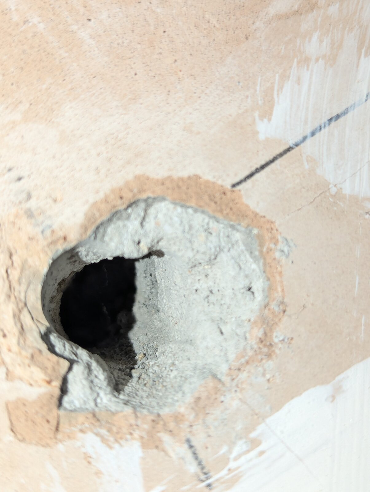

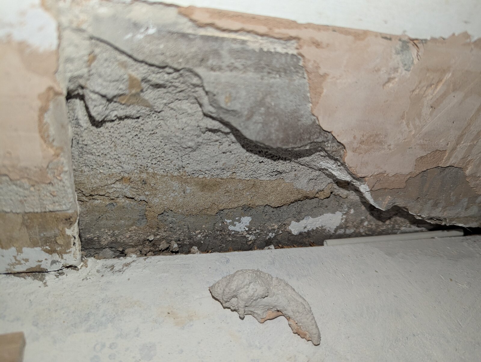

What filler type to use on this bathroom wall?

That'll be fine it's quick and easy to use.
You can also use a sand cement mixture.
Wet the area before filling in.
