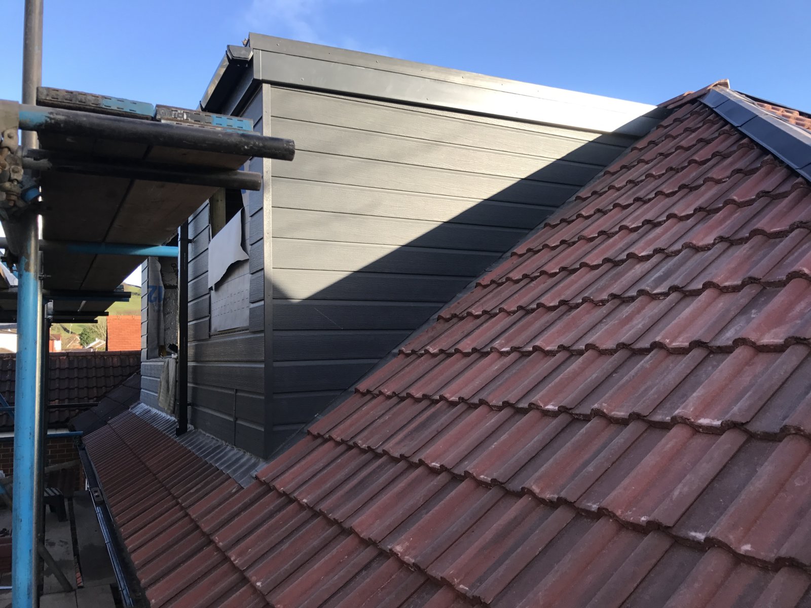

    I'm trying to achieve a dormer like this. What flashing is used?

    Lead

    Is it the flashband type?
    What size is used for sides and front?
    6inch side and 9 or 12 inch front?

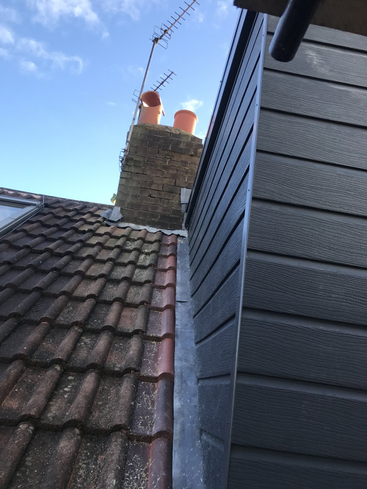

    There is no hard and fast rule only that you have the splash zone covered (vertically) and that you weather the heads of the tiles horizontally. Standard exposed verticals require a 150mm lead upstand, although the peculiarity of a dormer means that side abutting soakers can be weathered by the finishing material. Conc' interlocking tiles would need the standard head-lap weathering i.e. 75mm - 100mm (horizontally) down the tile or 100mm for plains.

    I’d say the raised profile is covered, and the cladding hides some of it so its good

    Good point. As with any profiled tile, it is important that the lead travels across enough of the tile so that the water is kept out by the profile and the cover.

    What's recommended to use code3, 4 or code 5 lead for dormer

    Code 4 lead flashings.

    3 and 4 for soakers 4 and 5 flashing
