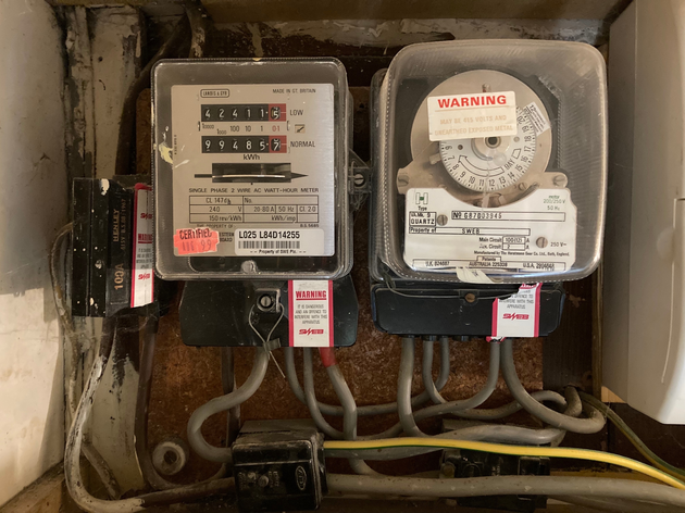

I can see no reason why a 'smart' meter would be required when one is doing some export IF both import and export were single-rate or, at most, 'fixed-time' dual-rate tariffs. My 'dumb' meter has the ability to record import and export separately for the two 'fixed' ('peak' and 'off-peak') periods - but the meter then obviously has to be read manually (by myself or a meter reader).
However, that's a big IF, since I'm not at all sure that any supplier offers a single-rate or dual-rate tariff including export (and nor whether anyone would want such a tariff).
The moment one wants a tariff which (for import and/or export) is 'dynamic' and/or which has more than two 'rate periods', there really is no option than to have what we call a 'smart' meter. I can't see that anything other than what we call a smart meter would be "suitable"! for such a tariff", no matter what Ofgem might say, can you?

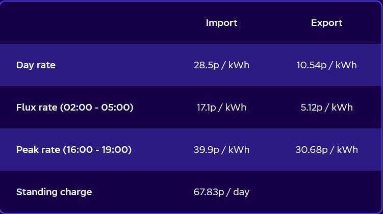

Octopus give different export rate depending on the tariff, the flux option 1746624431604.png most of the day only 10.54p I know that 30.68p from 4pm to 7pm but half of the year I am hardly going to produce at that time.
In fact, in winter I may be using power from the grid, at a massive 39.9p/kWh, so not sure why anyone would want that tariff?
Many of the tariffs require some access to solar inverter or car charger, so in the main these 6p/kWh tariffs are not available. Or they will not pay a reasonable rate for export.

But this needs a meter with some sort of output so it can turn the off-peak on at the same time as the appliances which use it, since the time of afternoon charge moves, without a smart meter, can see no way this can be done.
