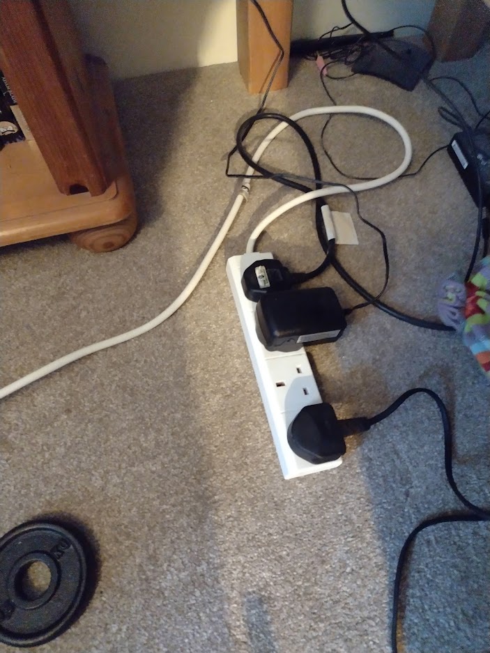

This little old extension lead was being used.
The other items are LED lights and a small LG TV.

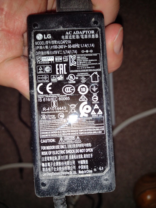

This is the TV adaptor

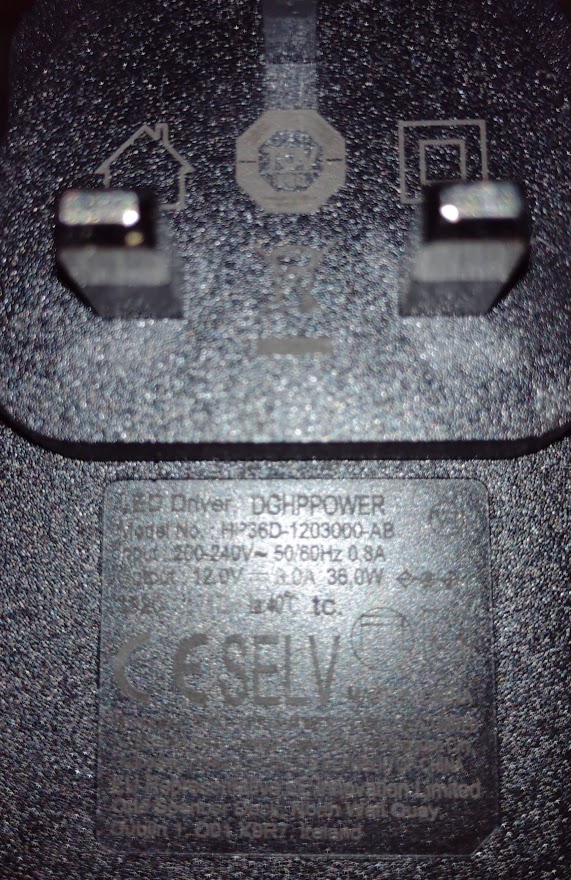

This is the LED plug socket (looks like 0.8A)

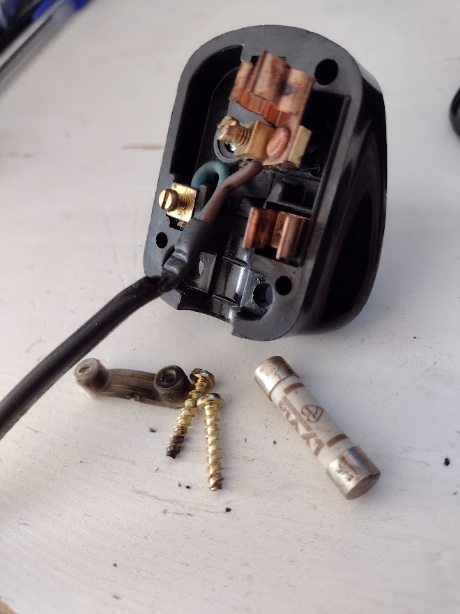

Open up the plug and post a pic...but it sounds like a loose connection.

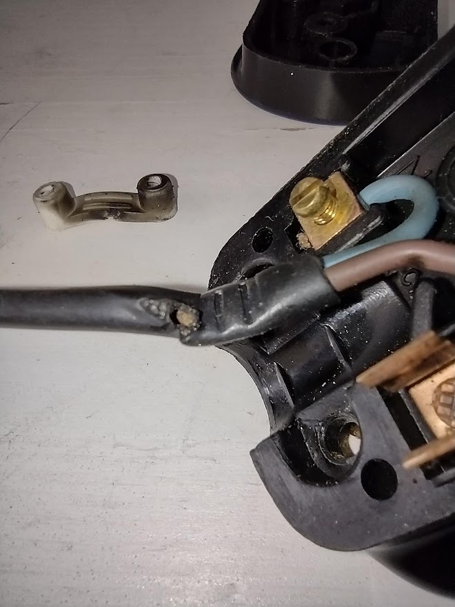

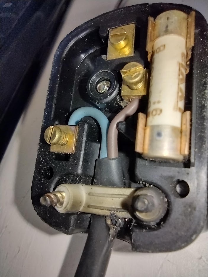

Looks melted, and smells burnt

That to me, looks like fatigue damage to the cord, where it meets the grip.
Eventually wearing through the cord and going bang!
But that's just my opinion! :)
Nothing wrong with your extension!
Depending on the state of the rest of the cord, that section can be cut off and the plug rewired.

Other picture also shows damage
I would be happy you have found the problem. Show your son and educate him into checking electrical items with his eyes, that will help him for rest of his life, if I wanted instruction photos I could not take better than those.
P.S. full marks on camera use, they are very good photos.
