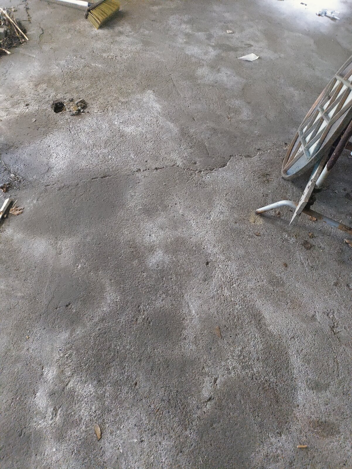

I don't know if there was some oil spoiled on the barn floor or if there is moisture problem or a drip from the roof.

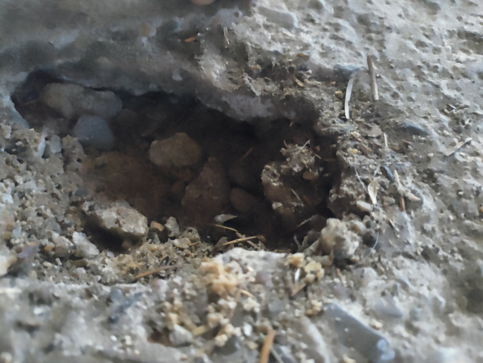

I expanded a hole so see the floor structure.
It looks like sand with aggregatet and cement layer above.

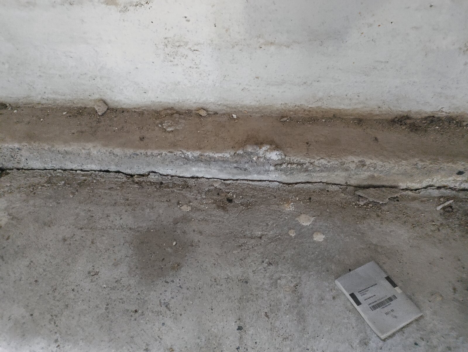

Where the floor joins the wall there is a step up.

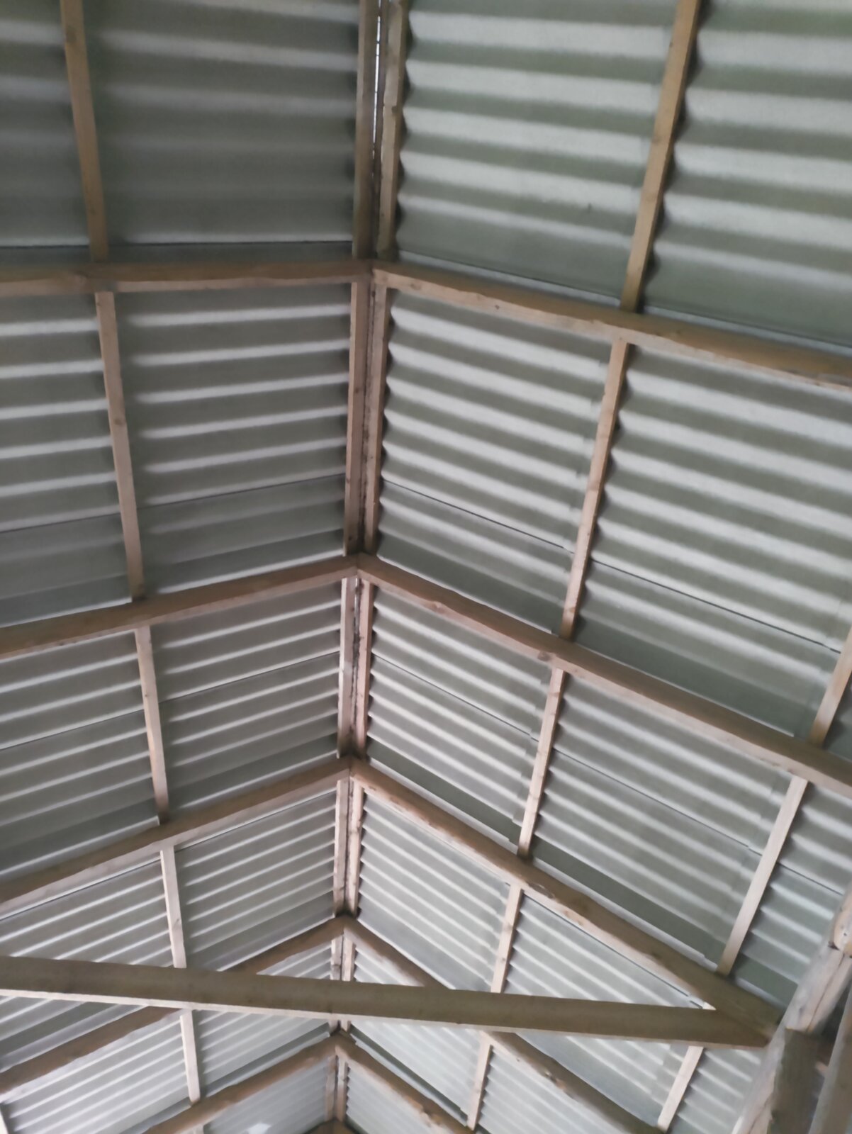

Finally here is a picture of the roof above.

What is causing the color variations in the floor?
Can I spray foam the join by wall and place rigid foam board and then place OSB board or just directly pour a self leveling compound. Should i place a foil barrier before or after Ridgid foam.
I'm concerned that those colour patches mean something sinister.
Wes
Lay a clear plastic sheet on the floor, weigh down at the edges, check it tomorrow, if there is condensation under the sheet, then it could be damp making it's way up through the slab. Could be condensation dripping from the roof, when it's cold and thawing/warming up.

I did a plastic sheet as you suggested earlier. There was no condensation or water on it in the morning when there was dew on the grass outside. I guess the colours are due to oil stains.

It looks in good condition, difficult to tell, but it could be thin layer of concrete, hard to tell from the photo.
What is the barn made from, steel sheet or fibre cement?

In the second picture I looked into a hole in the floor.
It appears to be concrete poured onto sand. It's not deep. Only an inch or two.
