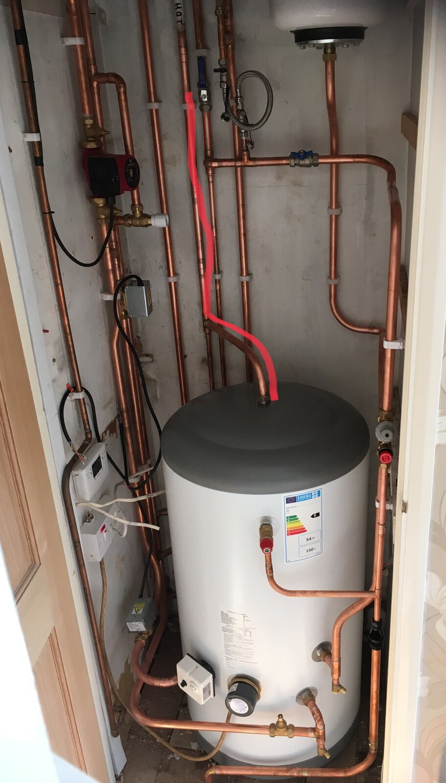

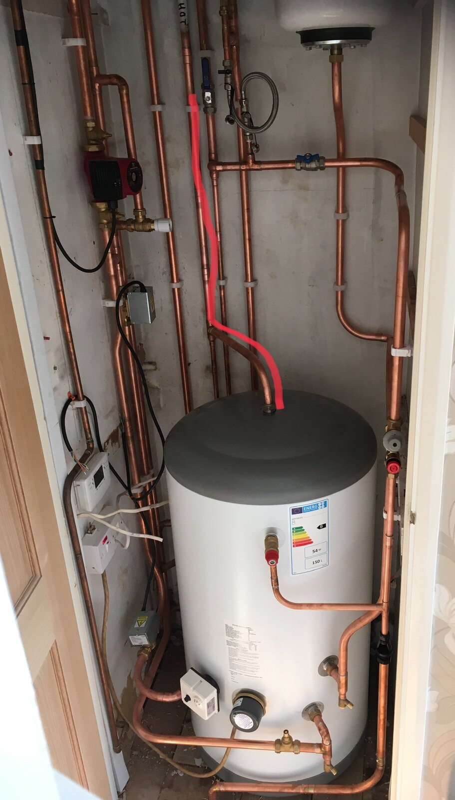

I agree but you also need the hot water pipes insulated well within the airing cupboard.

But the primarys from the boiler would do that. And you wouldn't have to make any sacrifice.
Regs state now that all pipes need to be insulated within a meter of the cylinder... The old girls don't like it...
So just insulate the hot water out pipe?
This pipe?
