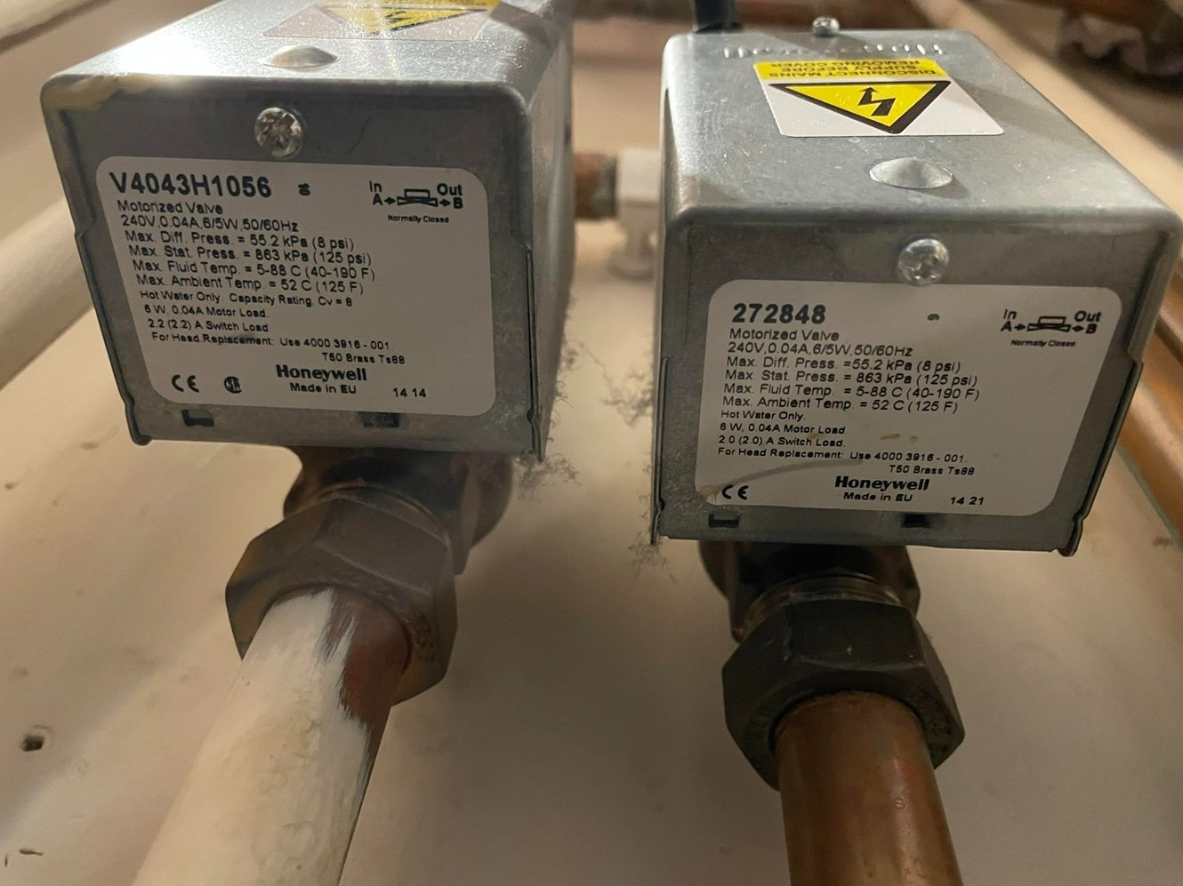

Sounds more like a sticking motorised valve imo. Do you know the make/model? If not, can you post a photo of them?
Hi. They are both Honeywell - see pic. They look the same but seem to have different model numbers - the CH is V4043H1056 and the HW is 272848

Thanks for the reply. I don't have a multimeter but I can ask someone. I can't hear the click of what must be the microswitch when the HW is meant to come on, only when I force the HW with the CH off or the system switched off/back on. If I switch the HW off I then hear the whirring of the valve closing.
If the HW valve opens fine on its own and fires the boiler on it will be the programmer at fault. The internals use a series capacitor to provide the supply to the electronics, this ages over time and can no longer provide the current required to power both CH and HW relays at the same time, but it is still able to power one at a time.
If you buy the same model you can just fit the new one to the old back plate without altering the wiring in the back plate. Just switch the mains off before taking the old one off.
Thank you Echo, yes, I think you're right, although once the HW is on both do work at the same time, so it may just be that initial connection?
I'll have a look at replacing it, hopefully straightforward. Thanks once again.
Quick update (in case anyone else faces same issue) - I avoided £80-90 on a new programmer (for now) simply by switching the central heating to timer mode but to be on all day (on @midnight - off@midnight so still controlled largely by the room 'stat) but switching off and on either side of the hot water coming on (twice a day). Seems to do the trick (for now).
