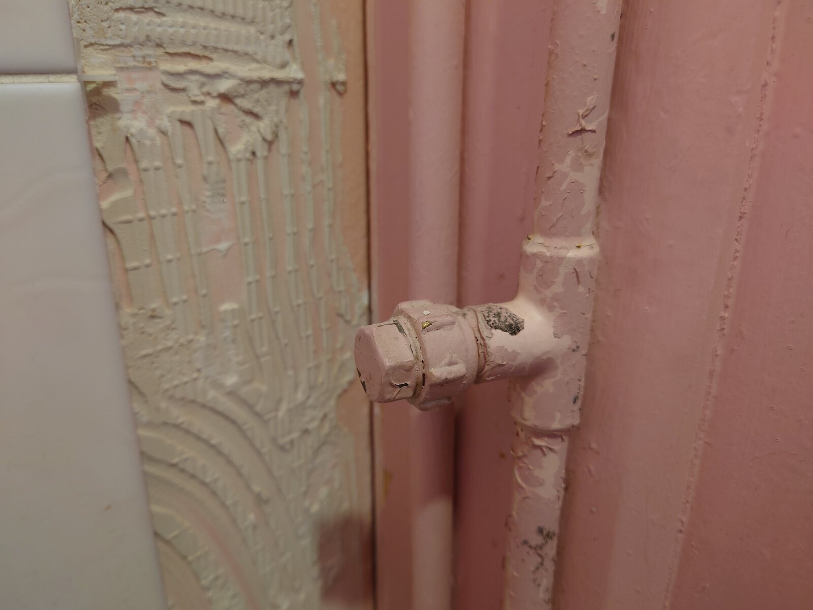

What is this and how do I take it off?
29 Sep 2024
2
Hello
Newbie here.
I have this connection on my mains cold water pipe, not far from the stop cock. I'm looking to box in the pipes but this connection is in the way and I'd like to remove it. Any ideas what it is and can I take it off and replace with some sort of straight connector?
My DIY level of skill is average at best!
Thanks in advance
Chris
Just a 'T' joint that’s no longer used. Just cut it out and make the pipe good.
"My DIY level of skill is average at best!"
Might be best to call a plumber in then especially looking at the state of the pipework.
It's above the stop cock, so thought I could turn the water off, open the taps and have a go.
I think you're right, I'll get someone in. Something's bound to happen and then I've got no water
