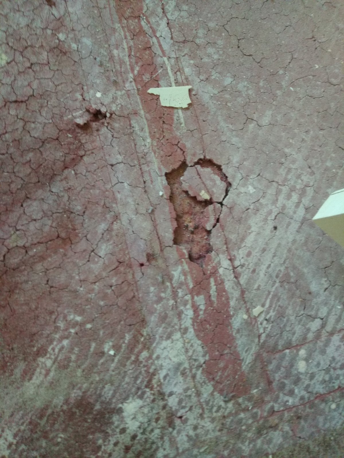

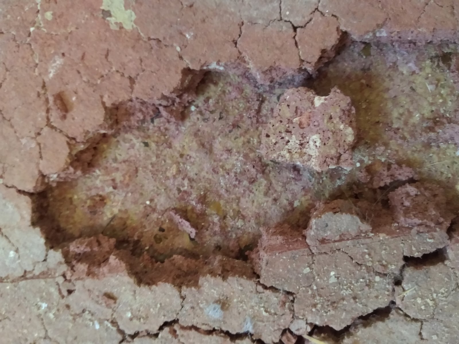

What is this floor material?
26 May 2019
4
Does anyone know what this floor is made of? It was under the carpet in my 1955 maisonette and I'm a bit worried it might contain asbestos!
I can attach more images if required.

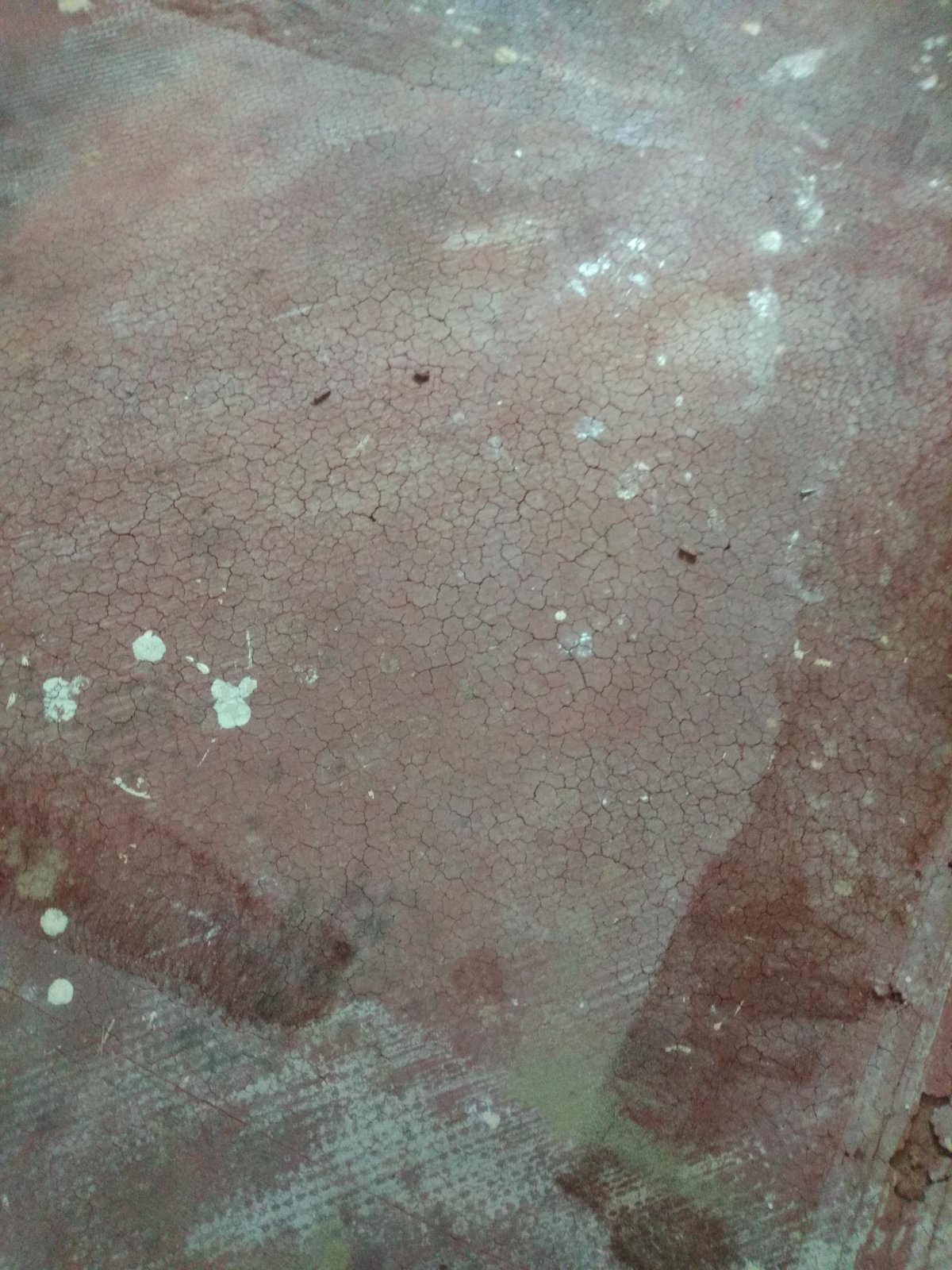

One more picture close up.

My initial thought, too, but if it were there would surely be some sort of woven hessian backing. How thick is it and is it friable (crumbly)?
In which case it would be best to get the material tested for asbestos as asphaltic materials often contained asbestos fibre fillers. This page can sometimes help identify stuff
Thank you. I don't think it's lino, it's quite thick and very crumbly.
I've been reluctant to dig down to check exact thickness in case it contains asbestos.
Quite possibly. I've ordered a home asbestos kit where you send a sample to a lab, just to be safe. Here's hoping it's not asbestos as my costs seem to be racking up quickly enough without that
It’s magnesite. Remove it and get the floor asphalted or latex screed with a liquid dpm.
