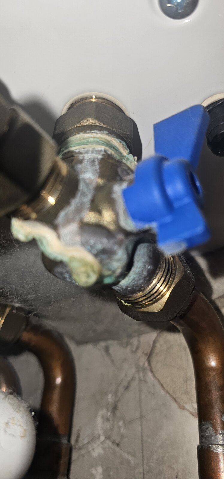

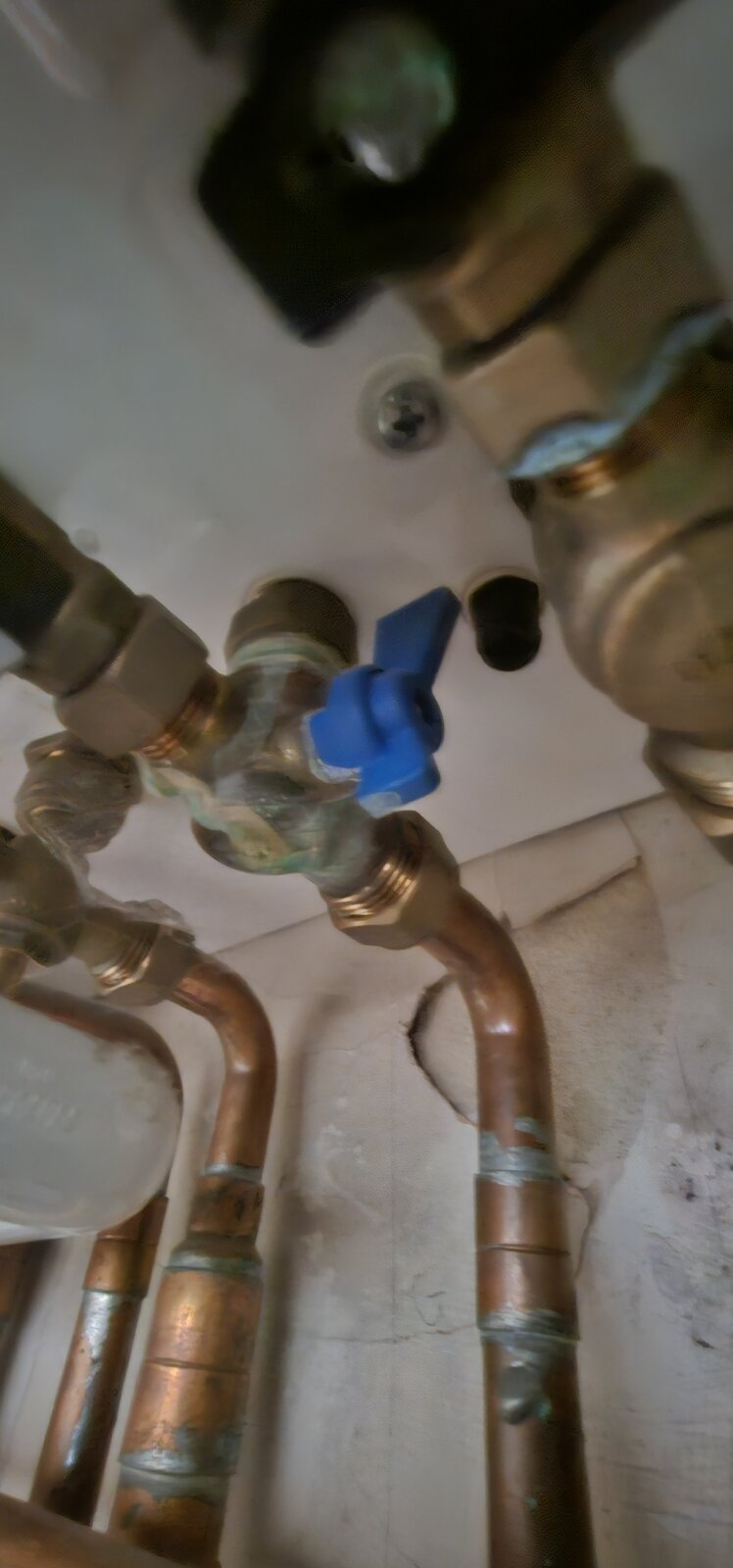

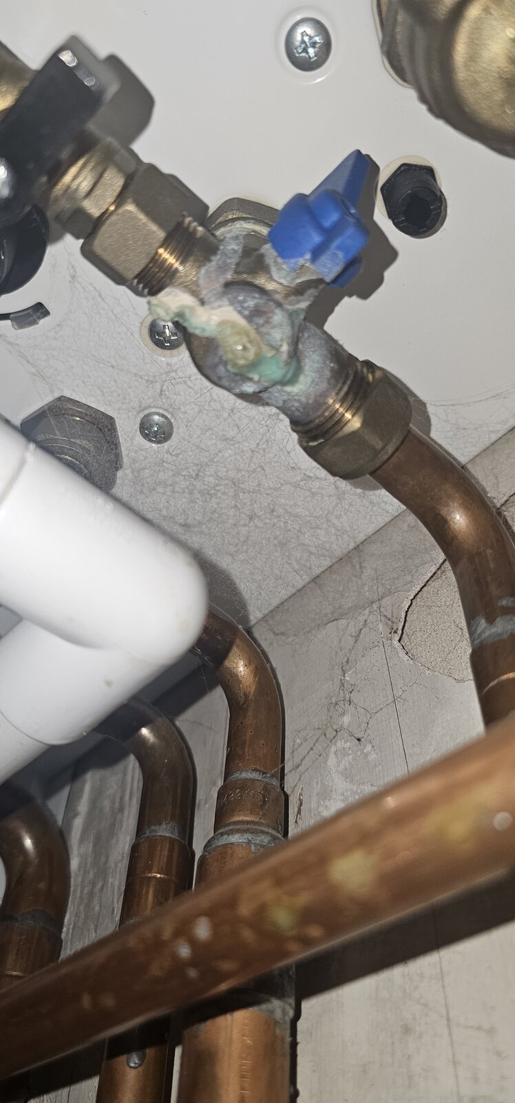

I have an ideal combo boiler and I have found that this valve is leaking. Can someone tell me what valve this is please, so I can buy one. Thank you
Not sure it's the valve that's leaking rather than the top connection - usually a fibre washer in there
If it is the valve then that's the cold inlet with the fill loop connection - it's called the DHW pack
There are 2 types - need to be sure which on is yours.
Yes it's the top connection. I can't get a spanner in there unfortunately. I have big hands.

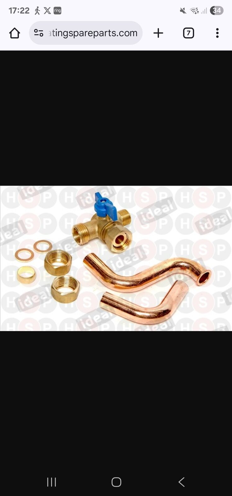

Looks like this one
