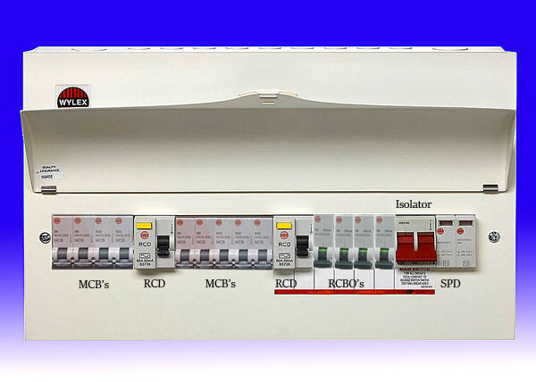

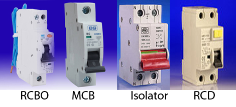

Eric showed you pictures of the various possibilities in post #2 (all of this things he depicts, apart from the 'isolator', can 'trip'. The most useful thing to tell us is whether or not the thing that tripped has a 'test button' (which means RCD or RCBO - MCBs don't have a test button).

I did tell you! Yes it does. And it doesn't look like any of those pics. There is one trip, one reset button and a line of switches for the various circuits. It's what most people, me included, would call the 'fuse box', though there are no fuses, which is indeed why I put the phrase in inverted commas, Thank you JohnW2!
Could you post a picture of the offending 'fuse box' and let us know which trip, tripped!?
It may help us understand :)
Typical consumer unit with the parts identified. There is I am sure a test button with the RCBO's but not easy to see it. Had to photoshop it together and could not find a picture of a RCBO direct on. It seems likely the items tripping is the RCD, which as well as test button will have other markings Type A.png for example. Or 30 mA or 0.030 A there will be something.
Seems likely it is a RCD tripping and where there are 4 or 5 MCB's and one RCD it can be a problem working out what has tripped it.
The RCD measures the difference between line amps and neutral amps, and assumes if not the same some current must be going to earth, a line to earth fault is normally easy to find, it is the neutral to earth fault which causes problems.

If the thing that is tripping (whatever it looks like) has a test button, then it is an RCD or RCBO (from your description, probably the former). As has been asked, can we have a photo of it or, failing that, could you tell us what is written on it?
