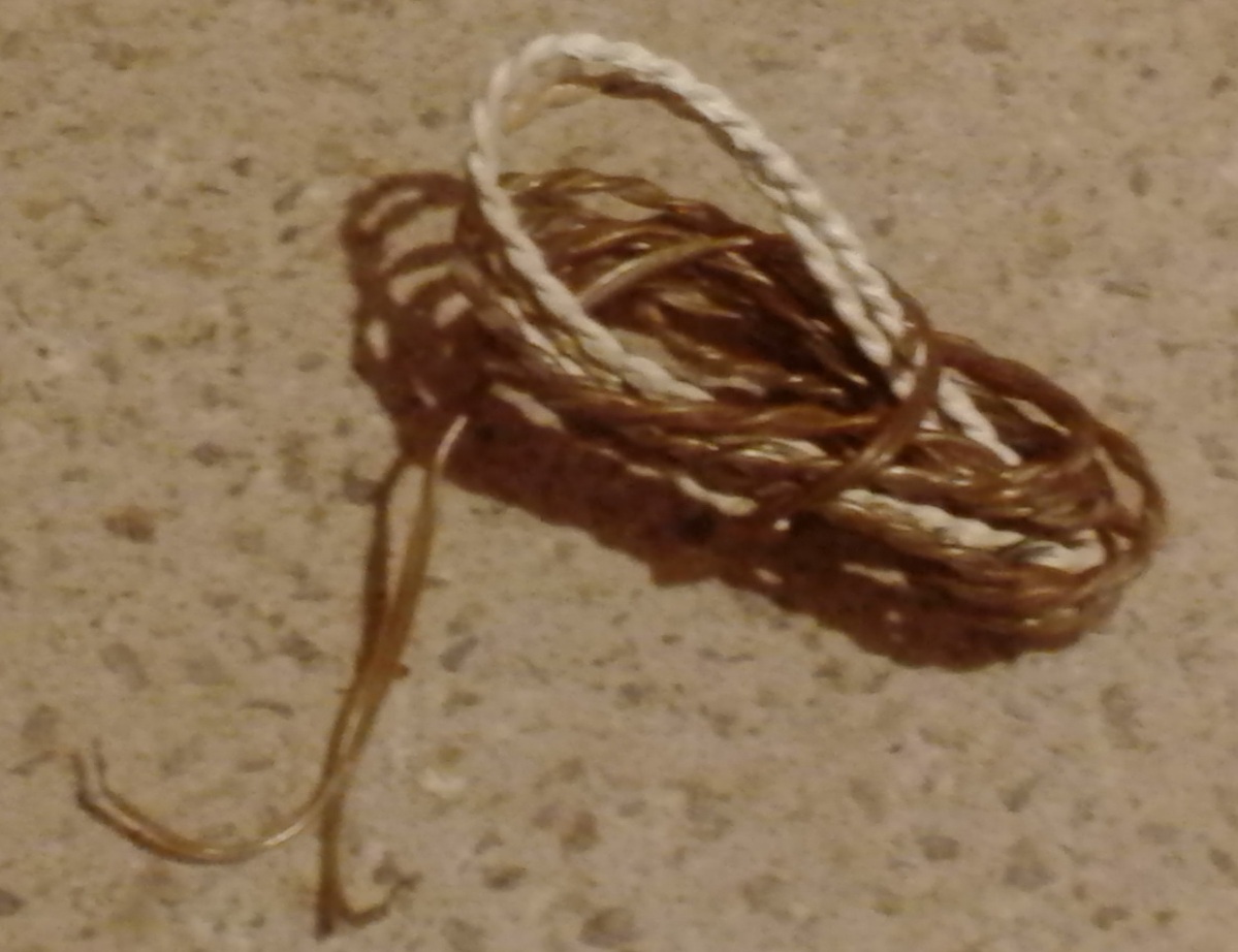

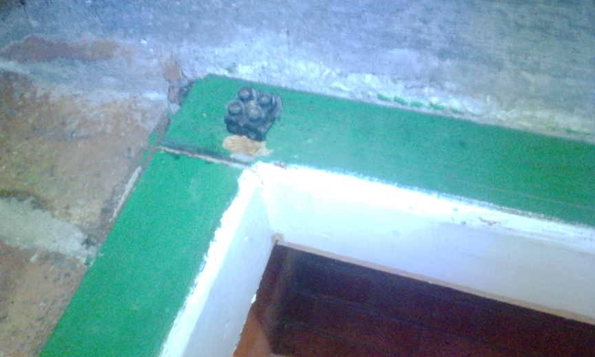

Investigated a bit further and checked the utility, the lights for which appear to be on the upstairs circuit. The cupboard for the utility had a light wired off the live and neutral of the main utility light (using very old/not even sheathed, just two single insulated wires twisted together) cable. What I hadn't spotted before was they'd drilled through the top of the door frame and shoved it through, and just on the other side untwisted said wire next to a bit of terminal block, one end screwed in other one joined right next to it with what I assume was a bit of old heat shrink. But they untwisted a bit soon, I hope this is what the issue was and it was causing a short between live and neutral. Now ripped it out as it looked so dodgy (I can live without the cupboard lighting)....what I don't get is why would a short on that circuit would trip the ring main (as well as an RCD on the upstairs lighting circuit, which I does make sense). Any ideas why a short on one circuit would make another trip welcome!? It is an old 50s house if it makes a difference. TN-S supply according to an inspection cert I have from a year or two ago.

Try some pictures, as some thing seems to have been missed in the telling.
Sorry, I wasn't clear. 6A on lighting circuit, 30A on ring main. There's only 3 circuits in use -upstairs lighting (6A), downstairs lighting (6A), ring (30A). Pics of the removed wire, and terminal block next to hole in doorframe attached! One end of this was wired to the main utility light live and neutral bars. The other end one bit went to the terminal block, and the other to another piece of wire using the presumed heat shrink (which practically fell off). Next to the terminal block where they were stripped, you could see they looked to be touching (or very nearly). The rest of the wire to the light itself and the lightswitch further down the doorframe was of the same type. No earthing to the cupboard light at all!
