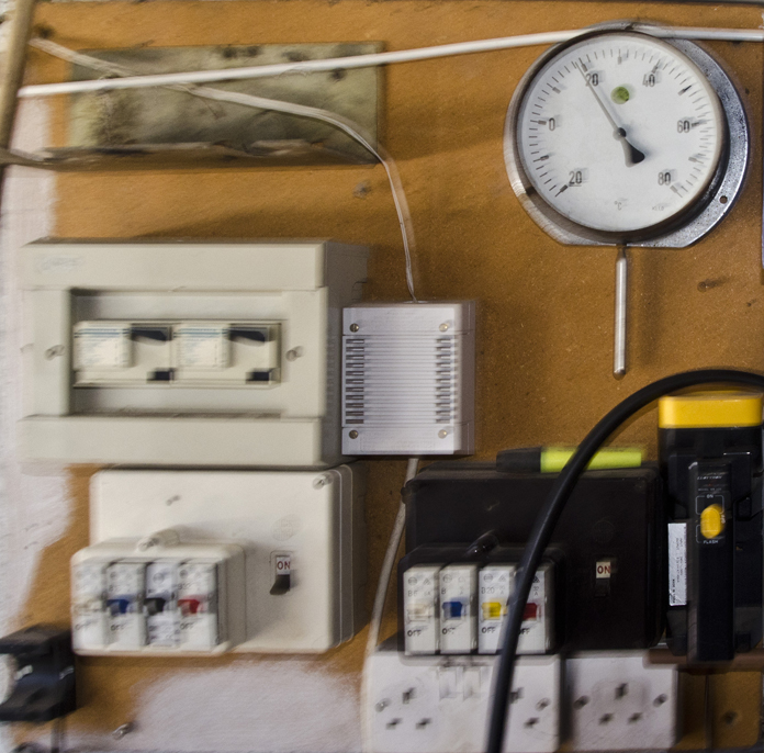

Fair enough - that's just a type of improvised 'power failure alarm' However, as said, that won't tell you about failure of a freezer which is still receiving power.
Our main freezer has a high temperature alarm, but that would give no warning if there was a complete failure. I bought separate battery powered unit, which displays the temperature and has settable temperature alarms. It is triggered even if the door is open for too long.
Oh sure, I certainly wouldn't rely on an alarm which was built into my freezer - all mine are, like yours, 'separate' and battery powered (but all connected to a central, battery backed-up, 'alarm system') - all being ones which I built very many years ago.
I have corresponding 'low temp' alarms on some of the bits of the plumbing/CH system in various dusty corners of my large house, connected to the same central alarm system, appropriate ones of which can be configured, if I wish, to turn on CH to relevant zones of the house if the temp of plumbing gets close to freezing.
